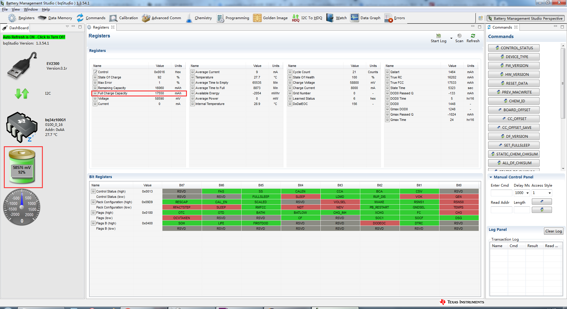

BQ34Z100-G1: After learning, the capacity exceeded expectations
Part Number: BQ34Z100-G1
as the picture shows:
According to the self-study process of the manual, the status is updated to 06 and the RA is updated to 0055, indicating successful learning. After successful, the full charge capacity is shown as 17550mah and the actual capacity is 16ah, which is too much, resulting in an estimated percentage of battery errors. If I continue to charge now, it is impossible to reach 17.5ah, and 58v (display voltage on the interface) should reach 100%, but now the interface is 92%, I think I will not reach full capacity, my termination current is set to 500ma ( My charging current is less than 230ma) and FC is not set. How can I solve these problems?
   I did self-learning and only performed a charge and discharge to learn successfully. Is it necessary to learn the actual capacity after looping?
配置文件:
pr.gg.zip
记录文件:
3630.data.zip
