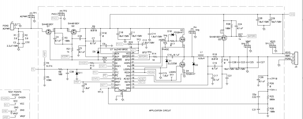

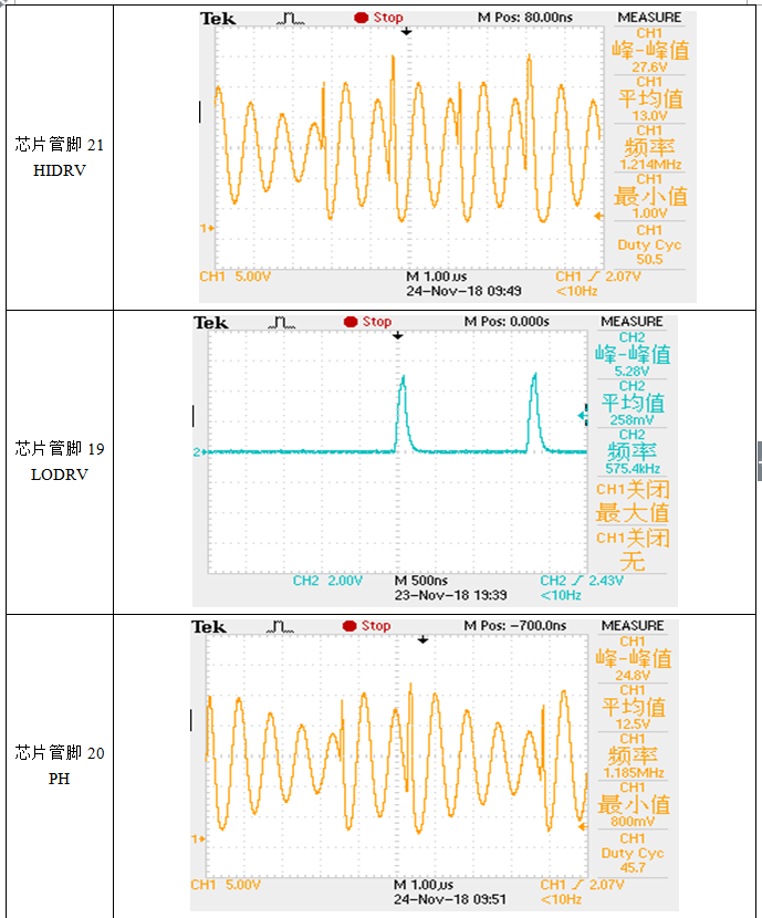

      my project is used in DC input 15V, charging is full of 12.6V charging circuit, I have two doubts, the first when I am empty, my two different items of boards HIDRV and LODRV and PH feet The switching frequency is different. The following is the waveform intercepted by the oscilloscope in my test. The second doubt is that the battery voltage I set is 12.6V, but the battery voltage I am full is 12.5. I have read the specifications and specifications of BQ24610. The 0.5% of the scale is a bit wrong. Can you give me the answer?

    when the lithium battery is working normally, the frequency of 19 and 20 and 21 feet is about 600kz. When the lithium battery is not connected, the frequencies of the three feet are the same, and the two different boards appear different. The frequency, I am very confused.
    It looks like the HIDRV is not stable, causing PH to dip. It is possible that this has something to do with BTST not being able to drive the HSFET on properly during the high cycle, causing LODRV to keep turning on to refresh BTST charge. Is it possible for you to share schematic? One other step would be to evaluate on EVM board, and configure it for your settings, as this board has been validated as a correct solution. You can test on EVM according to your 15V input, 12.6V battery application.

    I don't have the EVM of bq24610. The parameters on my circuit diagram are the same as the EVM of BQ24610. The only difference is D1. My diode can pass 100ma current. You can pass 380MA. The diode I use is PC32PF3000A1EP. I can pass 100MA, I wonder if it is for this reason. But I am surprised that it is normal when bringing a battery.
    It is possible, as your output voltage is close to input voltage, duty cycle will be high. Means that HSFET will be on longer than LSFET, and as BTST cap charges during the LSFET on time, the diode limiting continuous current could not be enough to charge BTST cap in this small LSFET on time interval. Are you using the same Q3 and Q4 as the EVM as well? High Qg can affect gate drive strength to turn on these FETs.

    my Q3 and Q4 use a lower gate capacitance, I checked the QQ of QQ and Q4 and Q4 of Q4 is 34nC, Q3 and Q4 on my board are 10nc, I am thinking about whether it is my board D1 The current limit caused, my D1 current limit is 100MA, yours seems to be 300MA, I can't apply for BQ24610deEVM here, I can't verify it, I can only test it on the board we painted ourselves in the last century.
