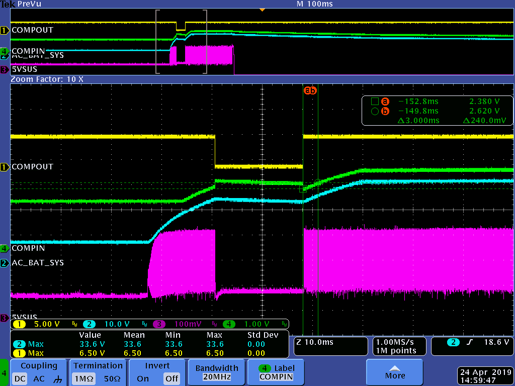

Hi,I am from ASUS SZ NB POWER Team.We have some questions about bq24780 now.Our protection use the independent comparator of bq24780(when CMPIN pull high,CMPOUT pin's output is low,our protect will be enable).We find independent comparator doesn't work at the second protection .
we can find COMPOUT pull  low when COMPIN is up to 2.3v at the first time.COMPOUT pull high only if COMPIN is under 2.3v.however,when COMPIN pull up to 2.3v again,COMPOUT doesn't
pull low.Can you give a reason for this? And we want to know the independent comparator's working conditions.
Thanks!
  • The question happens after ACFET/RBFET  latch  off.There is a test waveform picture.

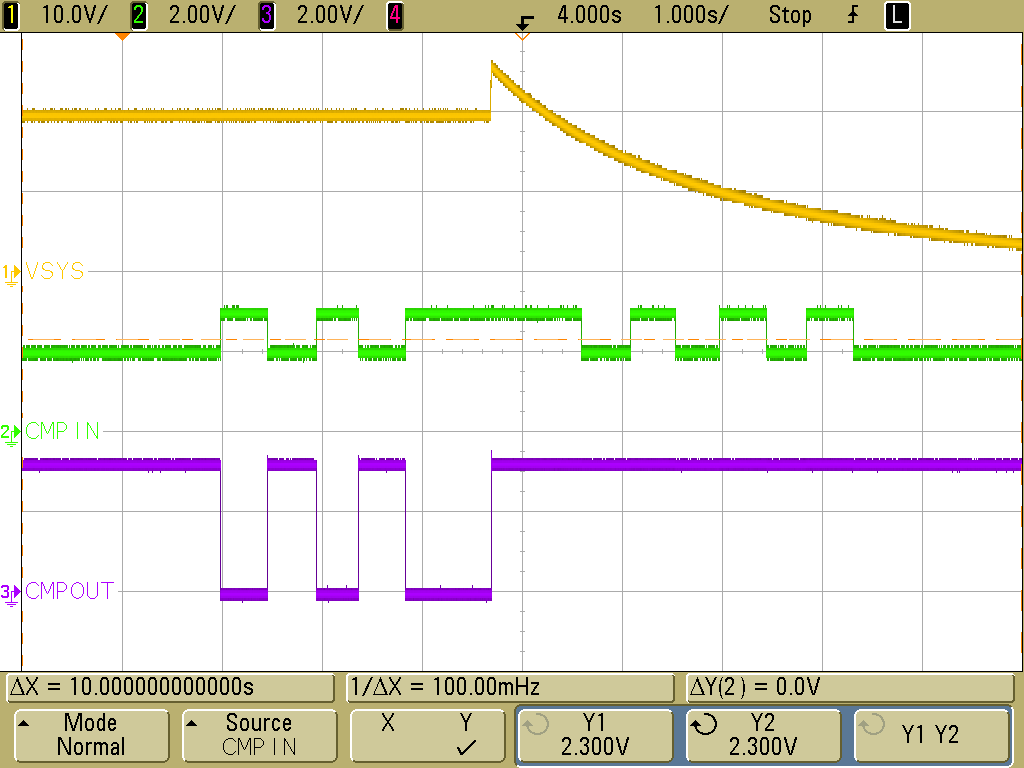

    In normal operation, the independent comparator should continue working. One possible condition that can cause CMPOUT to stay fixed to the logic high voltage is ACOVP (input overvoltage), which has a rising threshold of 26 V. In the waveform below, I set VIN = 20 V and toggled CMPIN between 2 V and 3 V. CMPOUT behaved as expected until I set VIN = 27 V and entered ACOVP. At this point, ACFET and RBFET latch off, causing VSYS to decay to 0 V, and CMPOUT is fixed at logic high even though I continued to toggle CMPIN.
    I'm not entirely sure what your labels for the blue and pink waveforms mean, but if the blue waveform is VIN, then this would explain the CMPOUT behavior you're seeing. After the blue waveform rises above 26 V, CMPOUT is fixed at logic high.
