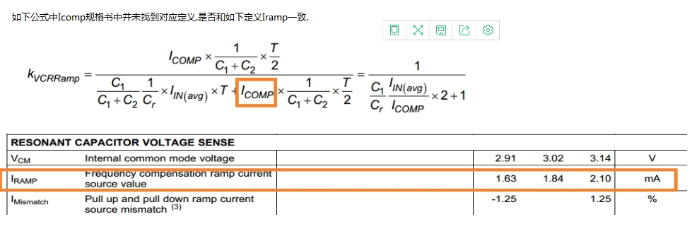

(1)VCR Pin:
The corresponding definition is not found in the Icomp specification in the following formula. Is it consistent with the definition of Iramp as follows?

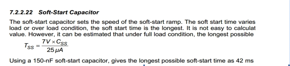

(3)Soft start
At present, the Css capacitor is 0.22uF, and the actual test soft start time Tss is only 22ms, which does not correspond to the actual calculated value.

    (1) You are correct, Iramp is the same as to Icomp

    (3) This equation is a worst case calculation. Section 2 in this app note (page 2-5) www.ti.com/.../slua836a.pdf explains in more detail how the soft start function works
