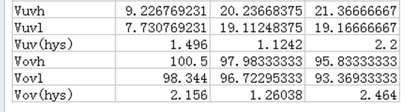

Hi Experts,
My customer has properly selected resistors based on calculations in datasheet. Below is threshold they have chosen. The reason they choose UVL lower than operation voltage, or OVL higher than ads rating is customer does not want LM5067 to protect during UV and OV scenarios. In other words, they do not want UVLO and OVLO, and it is because LM5067 must have R1-R3 so it can normally operate so they have to select resisors.
Except what has been noted in datasheet for value of resistance calculating, is there any other specs we should take care when choosing specific resistor? Like size, Power dissipation or voltage abs rating.
Thank you!
