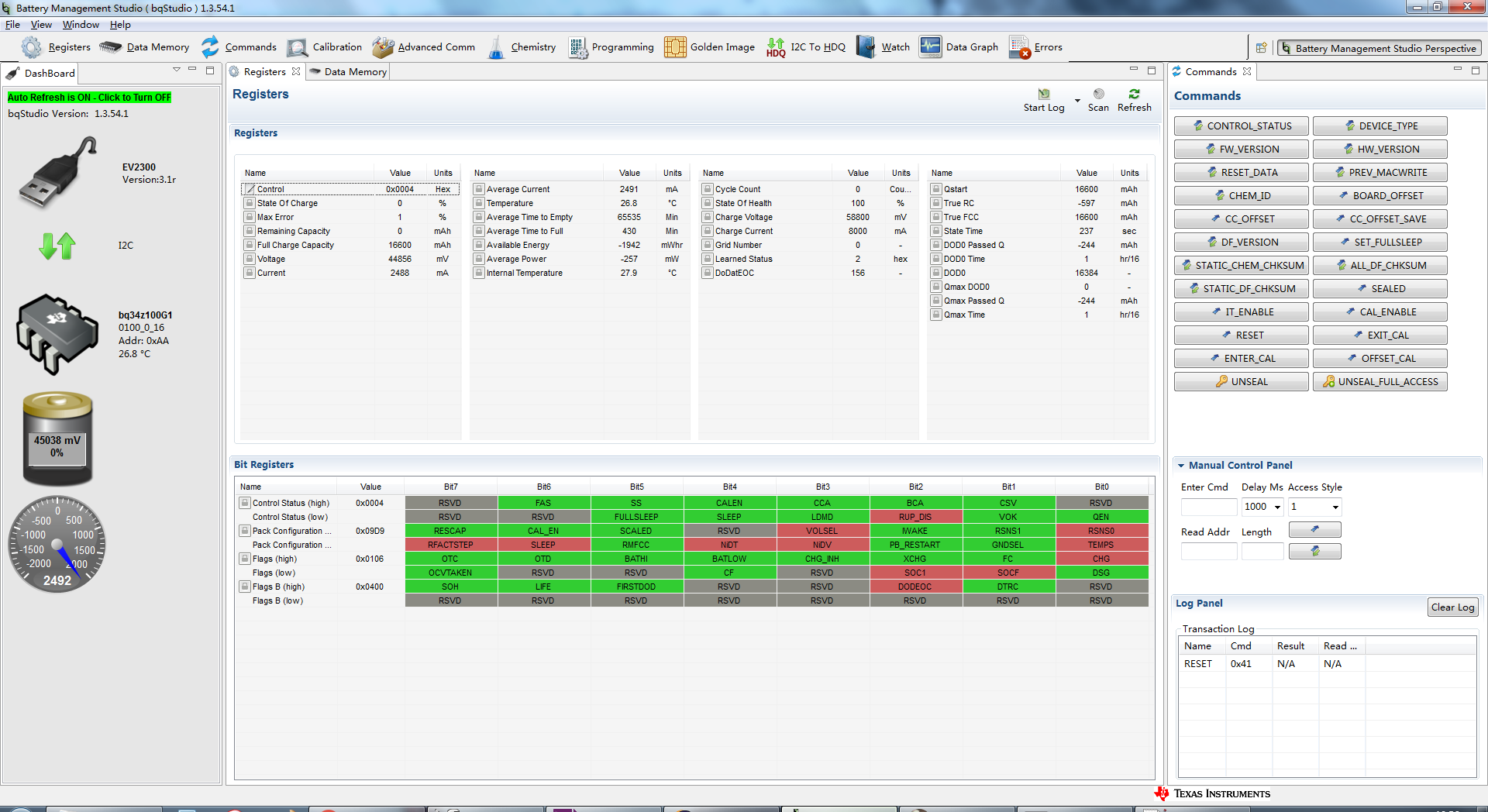

您好,TI技术专家:如图所示:我似乎已经学会成功,完全充电容量也符合我们的预期,但我把电池组的电量切断了,然后充电来验证功率是正确的。但我发现我用2.5a充电,但仪表总是显示0%?

    "Hello, TI technical expert: As shown in the figure: I seem to have learned to succeed, the full charging capacity is also in line with our expectations, but I cut off the battery pack's power, and then charged to verify that the power is correct. But I found that I used 2.5a to charge, but the meter always shows 0%?"
    I can't look at the SREC at the moment, if you could share the gg.csv file, that would be helpful.
    From what can be seen here:
    RemaingCapacity = FullChargeCapacity – Qstart = 0
    Remaining Capacity = 0
    FullChargeCapacity = 16600
    Qstart = 16600
    The gauge will run a FCC simulation when the device is reset - either through attaching the cells or using the reset command.
