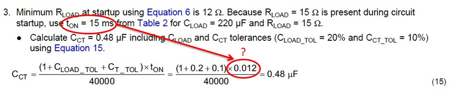

Hi Sir,
The Datasheet is show the Ton=15ms form Table2,  but Equation 15 key in 0.012.
Why is 0.012? not 0.015?
What's the Ton Rang Max & Min?
