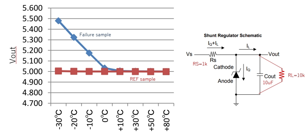

Our customer found a sample which has low accuracy at low temp. (Please see the following temp.)
Vs=8V, Vout=5V, LM4050AIM3-5.0
1. Do you think that accuracy of a failure sample is not normal at low temp?
2.Is there any wrong value for the external resistor and capacitor?
(I think the Rs is a little bit smaller than start value but it is not big problem for this case.)
