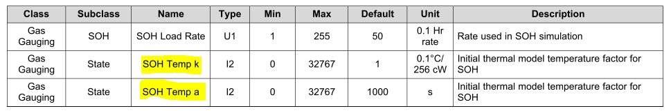

Hi team,
May I know the definition of SOH Temp k and SOH Temp? How to get the right values?
Miranda
  • Hi Miranda
    Those are parameters which the gauge uses for temperature optimization performance. You do not modify those on this gauge because the gauge dynamically modifies them based on use case. On our earlier gauges, those are called trise and t time constant and were fixed. You could use gpcra or gpcrb to modify those, but for this gauge you do not need to modify.
    thanks
    Onyx
