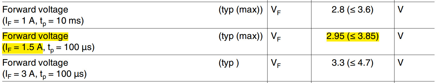

Please kindly help to check the schematic, especially the output capacitor.
We think the output capacitor nF level is very small in common DC/DC application, but according to equation28,30 in data sheet, the result is nF.
Our Vin=3.3V. LED VF as below, Vout=4.04V. Efficiency=0.9. Fsw=1.6M. LED dynamic resistance=2.

    First, where did the dynamic impedance come from? I found a datasheet with the SFH 4775S P.N. and get about 0.3 to 0.35 ohms between 2A and 1A Vf. Recalculate the output capacitor with a correct dynamic impedance. Dynamic impedance can be calculated as the slope of the Vf versus forward current (example, ((3.1V-2.8V)/(2A-1A))). The curve in the datasheet I looked at is lin/log and not very fine in resolution.
    Vin is 3.3V, why is Vout 4.04V? Also, with a boost configuration, there will be output when the LM3410 is off due to the boost feeding the output. When the LED is hot the Vf will drop making this worse. You may want to consider a SEPIC at these voltages (even though it's more complicated and less efficient).

    Vout comes from the max VF(3.85V)+0.19V=4.04V
    Re-calculate equation28 and 30 by RD=0.3
    I get C2>0.276uF.
