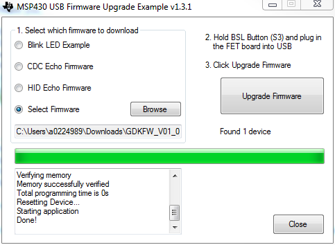

I am using bqstudio 1.3.86 and I have it connected to a bq27542G1 fuel gauge. I am trying to setup the EVM to run throughout the weekend to get charging and discharging data. I set the Auto Cycle to repeat the cycle continuously until manually stopped, but there is a point early throughout the weekend where the process stops automatically after a charge or discharge with the error "End Task (Unexpected): Charge - false" or "End Task (Unexpected): Discharge - false" and then prints out task complete. It continues to log values properly and it still shows connection to the fuel gauge, but the Auto Cycle just automatically stops for some reason so my assumption that there is something wrong with the bqstudio version or a process of the GDK I don't know about.
  • hi
    This is a problem that has been seen on the gdk in the past. Can you upgrade the firmware on the device  using the files below:

  • I accidentally did the GDK firmware upgrade when I had the switch set to "EV2400 FW update". Now I am looking for a proper way to set my EV2400 firmware back to it's original state. I tried downloading EV2400 Firmware Updater v0.18 but I continue to receive "This request is blocked by the Firewall Gateway Anti-Virus Service. Name: Ransom.DC (Trojan) blocked". Do I need to continue this route in order to fix my problem or do I go about this some way else?
  • I have downloaded a link for an EV2400 updater from this thread.
    e2e.ti.com/.../699599
    I ran the program with the '-s' flag and now the BQ27GDK is working like it is supposed to. I have properly updated the GDK firmware and I will come back with a response within the next week or so.
