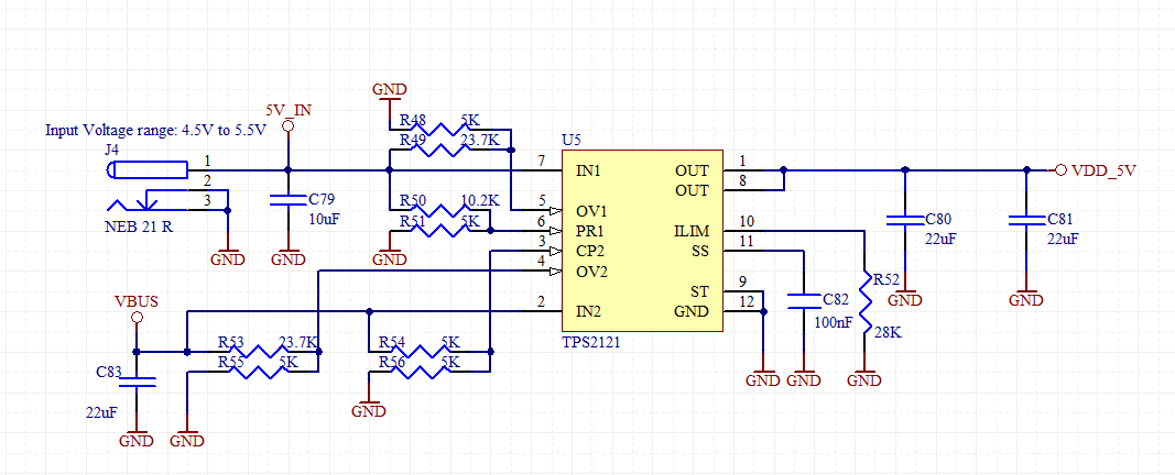

Hi
We are using TPS2121 in one of our design and the circuit connection is as shown below
We are hoping that always IN1 takes priority. The circuit works but always we see IN1 is selected irrespective of other conditions. When only IN2 is present we don't see any output. I have tried removing R50, VBUS is power by 5V source and 5V_IN floating or no connection. I was expecting to VBUS voltage at the output but no voltage.
Is there anything wrong in the circuit connection. The operating condition we are looking at is that when both 5V_IN and VBUS is present, 5V_IN should be switched to the output when only VBUS is present then we want the VBUS to be switched to the output.
Please let us know what is missing in our circuit.
