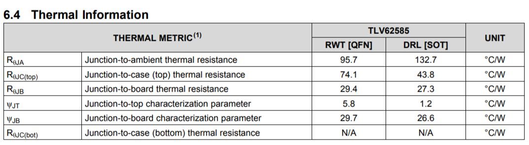

Hi ,
May I ask that why the junction to ambient of QFN is better than SOT, but the other parameter of SOT is higher than QFN package?
Thanks for your help.
  • Dear Customer,
    QFN package relies on its 12 pins to transfer the heat to the air hence it has lower Rth(j-a) versus DRL package (6-pin).
    On the other hand, DRL package has thinner mold compound (non-conductive protective material of the IC) compared to QFN package making its Rth(j-c) & Junction-to-top characterization parameter lower. As a rule of thumb, the higher the package height the thicker the mold compound.
