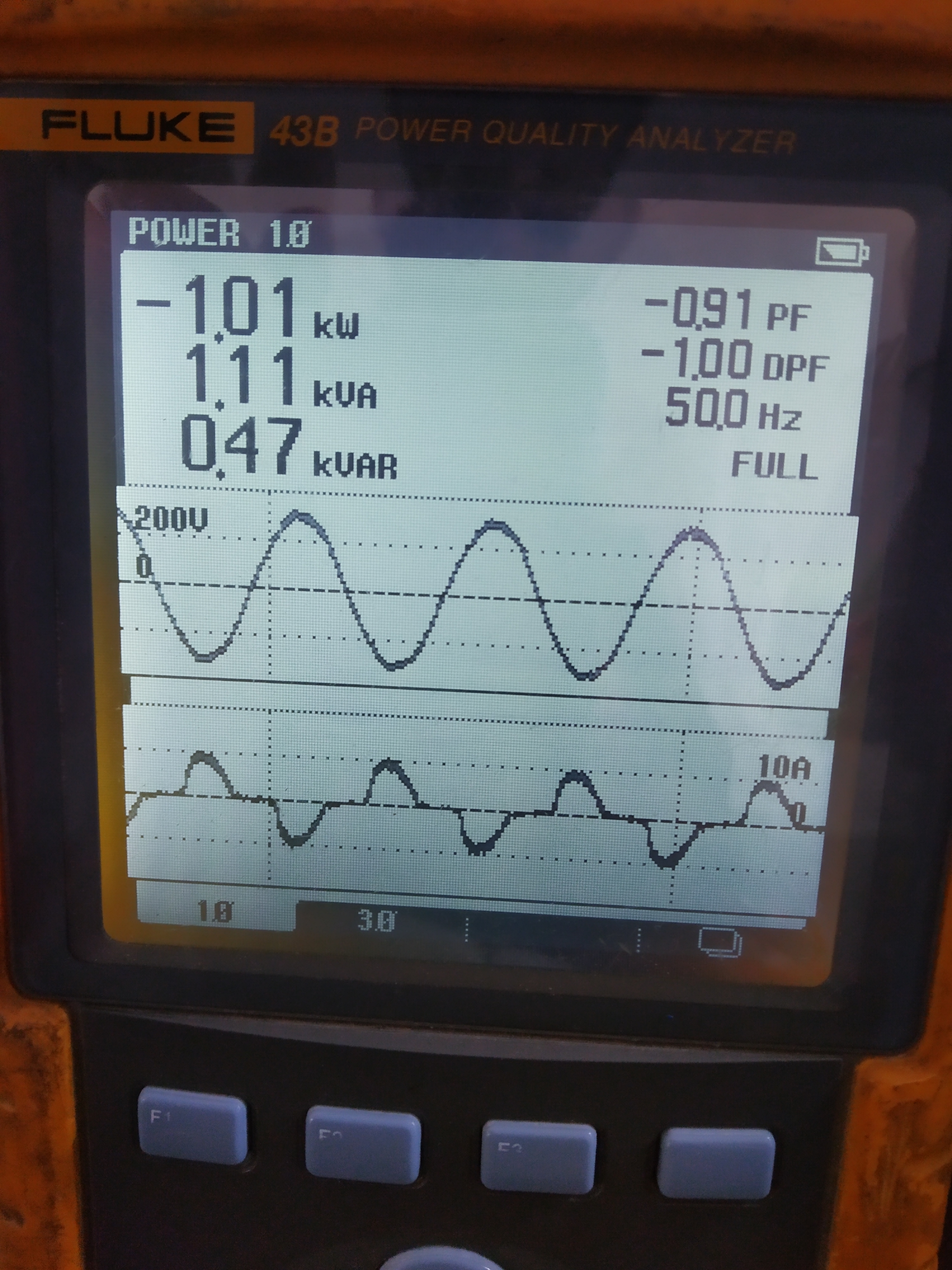

Hi Everyone,
I am using UCC28070A for my PFC circuit,
Vin:120Vdc-375vdc
Vout:380Vdc
I Out(max):5.8A
Max i/p Power:2200W
i am using current sense resistor at the source of the mosfet instead of CT in drain.
But i get Poor Power Factor (0.89-0.94).
i have attached the schematic.Please Help me to solve this issue.
Thanks in advance,
Kumar.V 2477.SCHEMATIC1 PAGE1.pdf
