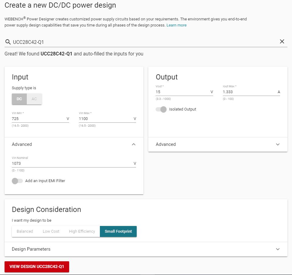

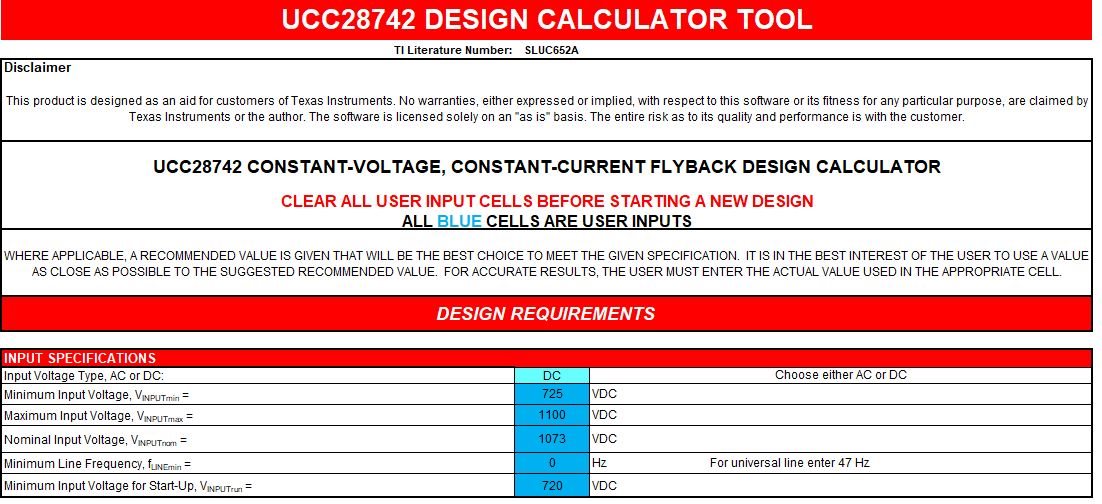

I am having a hard time finding a MOSFET for the UCC28742 that will allow for valley switching.
How critical is it to achieve this?
What are the side affects of not valley switching besides lower efficiency and more power dissipated by the MOSFET?
Do you know of any MOSFETs that will better achieve valley switching?  So far even with $40 parts, I can not achieve this and be within the current rating of the MOSFET.
MOSFET Switch, Q
Reflected Voltage, Vreflected = 640.0 V Variable definitions refering to the diagram on the sheet of SCHEMATIC AND BoM
Leakage Spike Voltage, VLK =   416.0 V
Required Drain to Soure Voltage Rating , VDSrated = 2156.0 V
Leakage Spike Voltage / Reflected Voltage, Ratio = Vlk / Vreflected  0.65   User input and initially around 0.5 to 0.7
MOSFET Rated Drain to Source Voltage, VDS = 2500 V
Output Capacitance of Selected MOSFET, COSS = 77 pF Design will not Valley Switch
Drain to Source On-Resistance of Selected MOSFET, RDSon = 40
MOSFET Fall Time, tf = 39 ns
MOSFET Turn Off Delay Time, tDoff = 132 ns
MOSFET Total Gate Charge, Qg = 65 nC

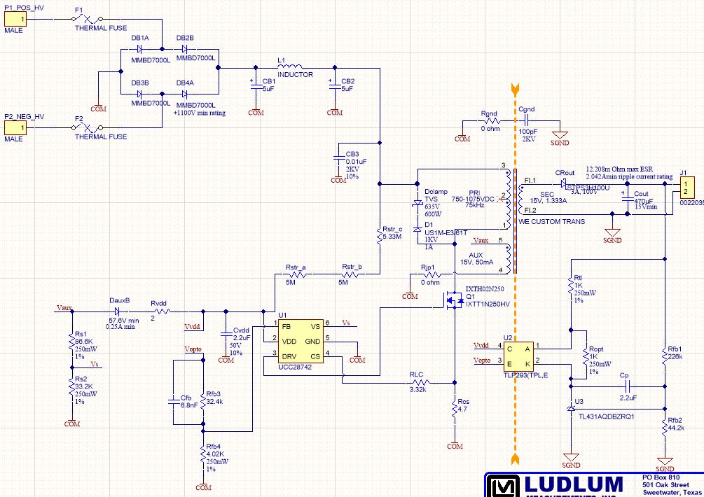

  • I am not sure why you are having issues with Valley switching?
    Could you provide schematic and power levels?
    Could you also take waveforms of the Aux winding, Drive Pin and Current Sense pins so we can see where the device is actually switching?
    Mike
  • I do not have waveforms to view at the moment, because I am still in the process of sorting out the correct components using the design tool.
    Once I have these correctly set, I will move to layout and PCB manufacturing and test, but I want to make sure I have setup the design correctly.

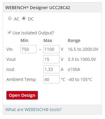

    Currently, I can not find a MOSFET to achieve valley switching at the current level needed.
    The design takes a DC input voltage (725V to 1075V) from a large capacitor bank as the input.
    The output needs to be 15Vdc at 1.3Amps.  The output voltage range during operation and various load states must remain between (14.5V to 15.5Vdc) with the typical value being 15Vdc.
    One thing I think I need to look at is revising the Vaux turns since I originally thought I'd just need 40 turns just like the secondary to have a 15V aux, but this calculator is showing I need more like 65 turns which is quite a bit more?
    I am also looking at a startup circuit to allow the circuit to start up quickly.

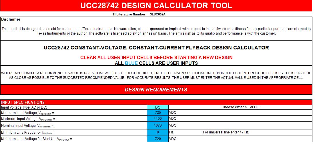

    UCC28742 DESIGN CALCULATIONS
    The Values Entered by the User on the DESIGN INPUT Page are Used in the Design Calculations
    ALL Gray CELLs from BLUE CELLS ARE USER INPUTS - changes only made to BLUE cells
    INPUT
    Input Voltage Type AC or DC: DC User Input Values From Design Input Page
    Minimum Input Voltage  VINPUTmin = 725 VDC
    Maximum Input Voltage VINPUTmax = 1100 VDC
    Nominal Input Voltage  VINPUTnom = 1073 VDC
    Minimum Line Frequency  fLINEmin = 0 Hz
    Minimum Input Voltage for Start-Up VINPUTrun = 720 VDC
    Minimum Peak Bulk Input Voltage  VBULKmin = 725.0 V
    Maximum Peak Bulk Input Voltage VBULKmax = 1100.0 V
    Nominal Peak Bulk Input Voltage VBULKnom = 1073.0 V
    Turn-On Peak Bulk Input Voltage VBULKstartup = 720.0 V
    Line Cycle Period, maximum, (corresponding to fLINEmin) tLINE n/a ms
    OUTPUT
    Regulated Output Voltage, Constant Voltage Mode  VOUT_CV = 15.0 V User Input Values From Design Input Page
    Full Load Rated Output Current IOUT = 1.3 A
    Target Constant Current Mode Output Load Threshold IOCC_target = 1.5 A
    Target Minimum Output Voltage During Constant Current Regulation VOUT_CC = 14.0 V
    Allowable Output Voltage Drop During Load-Step Transient in Constant Voltage Mode VOUTΔ = 0.05 V
    Maximum Peak to Peak Output Voltage Ripple VRIPPLE = 80 mV
    Required Positive Load Step Transient Current ITRAN = 1.3 A
    Maximum Allowable Response Time to Load Step Transient tRESP = 0.1 ms
    Output Over Voltage Protection VOUT_OVP = 15.5 V
    Maximum Stand By Power Dissipation PSBtarget = 75 mW
    Estimated Efficiency η  = 0.850
    Output Power POUT = 22.500 W
    Estimated Input Power PIN = 26.471 W
    COMPONENT PARAMETER CALCULATIONS

    VS Line Sense Stop Current, Nominal IVSLstop_nom = 75 µA Device Parameter
    VS Line Sense Stop Current, Maximum IVSLstop_max = 90 µA Device Parameter
    Recommended Resistor Value for Minimum Start Up Line Voltage RVS1recommended = 86.6 k
    Actual Resistor Value Used for Minimum Start Up Line Voltage RVS1actual = 86.6 k User Input
    RVS1 Value Used in Calculations RVS1 = 86.6 k
    Resultant Turn On Voltage, Minimum  VTURNONmin = 588.9 VDC
    Resultant Turn On Voltage, Nominal  VTURNONnom = 727.4 VDC
    Resultant Turn On Voltage, Maximum  VTURNONmax = 866.0 VDC
    Resultant Input Brown Out Voltage, Minimum VBROWNOUTmin = 212.8 VDC
    Resultant Input Brown Out Voltage, Nominal VBROWNOUTnom = 264.8 VDC
    Resultant Input Brown Out Voltage, Maximum VBROWNOUTmax = 316.8 VDC
    Internal VS Over Voltage Threshold, Minimum VOVPmin = 4.45 V Device Parameter
    Internal VS Over Voltage Threshold, Nominal VOVPnom = 4.65 V Device Parameter
    Internal VS Over Voltage Threshold, Maximum VOVPmax = 4.85 V Device Parameter
    Recommended Resistor Value for Desired Output Over Voltage Limit RVS2recommended = 33.2 kΩ
    Actual Resistor Value Used for Desired Output Over Voltage Limit RVS2actual = 33.2 kΩ User Input
    RVS2 Used in Calculations RVS2 = 33.2 kΩ
    Resultant Output Over Voltage Threshold, Minimum VOUT_OVPmin = 15.058 V
    Resultant Output Over Voltage Threshold, Nominal VOUT_OVPnom = 15.779 V Actual Output Over Voltage
    Resultant Output Over Voltage Threshold, Maximum VOUT_OVPmax = 16.501 V
    LINE COMPENSATION, RLC
    Line Compensation Current Ratio, Nominal KLCnom = 25 A/A Device Parameter
    Total Estimated Current Sense Delay tDELAY = 182 ns
    Recommended Resistor Value for Line Compensation RLCrecommended = 3.320 k
    Actual Resistor Value Used for Line Compensation RLCactual = 3.320 kΩ User Input
    RLC Used in Calculations RLC = 3.320 kΩ
    Result of RLC selection Output Constant Current will have minimal deviation over input line voltage range.
    VDD CAPACITOR, CVDD
    Device Supply Current During Run Mode, Maximum IRUNmax = 2.40 mA Device Parameter
    VDDON Voltage, Maximum VDDONmax = 24.5 V Device Parameter
    VDDOFF Voltage, Maximum VDDOFFmax = 8.30 V Device Parameter
    Estimated Minimum Switching Frequency at No-Load fSWmin = 3.252 kHz
    Estimated Over Voltage Charge Duration tOV = 2.0 ms
    Minimum VDD Capacitor for Start UP CVDD1 = 2.200 µF
    Minimum VDD Capacitor for Load Transient CVDD2 = 1.000 µF
    Minimum VDD Capacitor for Target Ripple on VDD CVDD3 = 0.680 µF
    Recommended Capacitor on VDD CVDDrecommended = 2.200 µF
    OPTO-COUPLED FEEDBACK
    Reference Voltage of TL431 Shunt Regulator VREF431 = 2.495 V User Input
    Shunt Regulator Reference Input Current, Maximum IREF431 = 4 µA User Input
    Recommended Bottom Resistor Value for Output Voltage Set Point RFB2recommended = 44.2 k
    Actual Bottom Resistor Value Used for Output Voltage Set Point RFB2actual = 44.2 kΩ User Input
    RFB2 Used in Calculations RFB2 = 44.2 kΩ
    Recommended Top Resistor Value for Output Voltage Set Point RFB1recommended = 226 kΩ
    Actual Top Resistor Value Used for Output Voltage Set Point RFB1actual = 226 kΩ User Input
    RFB1 Used in Calculations RFB1 = 226.02 kΩ
    Resultant Nominal Constant Voltage Output Voltage VOUT_CV = 15.253 V
    Recommended Value For RFB4 RFB4recommended = 4.02 k
    RTL Used in Calculations RTL = 1.5 k
    * All reference designators can be found in Schematic and BoM sheet
    On the Schematic BOM tab of the UCC28742 calculator it give specs for the MOSFET Q1 as follows:
    Q1 Minimum VDS Voltage Rating: 2500 V
    Minimum Continuous Current Rating: 0.669 A
    Minimum Repetitive Peak Current Rating: 1.784 A
    Power Dissipation: 1.307 W
    Does the MOSFET current rating really need to be 669mA cont. and 1.784A peak?
    The 1st table shows the primary current will only be:
    Peak Primary Current, Maximum, Full Load IPPmax = 0.177 A
    Clint
    I believe the tools calculation for peak and RMS current for the FETs is correct.
    In regards to not being able to find a FET that will allow valley switching. This device will valley switch if half the resonant period between the primary magnetizing inductance (Lp) and the switch node capacitance Co(tr) is 2 us. Co(tr) < or = 1/((2*3.14*500kHz)^2*Lp. If you can’t find a FET with a low enough Co(tr) you could consider lowering your fmax to increase Lp.
  • Hi Mike,
    I tried adjusting the frequency do to 70, then 65, then 50, then 10kHz and still no matter the frequency setting and adjustment to the primary inductance and primary/secondary turns ratios, I still get the message that the design will not Valley Switch.
    It looks like the only way I can get the design to valley switch is to lower the Output capacitance (Coss) to 10pF or less.
    Once the Coss value reaches 11pF or higher, then the design states will not valley switch.
    I had originally found a MOSFET that would meet the Coss requirement, but the current rating of the MOSFET was too low.
    As I search for higher current, high voltage MOSFETs I am finding them all to have at least 77pF, 100pF, or even higher Coss.
    I really need the frequency to be high as possible to keep the Flyback transformer as small as possible to save board space.
    Are you aware of any type of 2500V or greater MOSFETs that typically have low Coss?
    Your design is unique and due to your high input voltage and power level. Finding a FET that achieves ZVS may not be possible. The UCC28742 is limited to resonant frequencies below 500 kHz.
    If ZVS is required it is possible that this cannot be achieved using the UCC28742. You might consider evaluating a different device to see if it meets your needs. The UCC28600 is a QR fly back controller that might be able to meet your design requirements.
    The other option is design a hard switched fly back convter. The UC28C42 could work for this application.

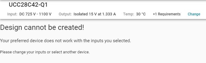

    I tried setting the inputs with the UCC28C42, but apparently something is not working out.
    My input voltages are within the specified range 16.5-2000V
    I am not the creator of the Webench tool and this input range seems to wide. However, the device should function in the design range you are trying to achieve but it won't achieve ZVS. It will hard switch.
    Please note there is TZTO zero crossing timeout delay of 1.45 to 3.3 us. What This means is if a quarter of your resonant period between Lm the switch node capacitance this device will hard switch. It will still function but no ZVS.
    Lastly I see that you posted that the Webench tool should be capable of doing this design because it is in the tools range of 16.5V to 2000V. I think that is in error and I am going to assign this to the Webench team to resolve.
  • To the Webench team can you looking this and resolve Clint's issue with the Webench tool? It is not capable of doing his design.
    I believe the input range is in error.
  • Hi Clint,
    I tried creating the design for the condition reported,I am able to create the design.
    I have shared the design in link mentioned below.
    Shared design link: webench.ti.com/.../SDP.cgi
    Could you please let us know if you are able to create the design now.

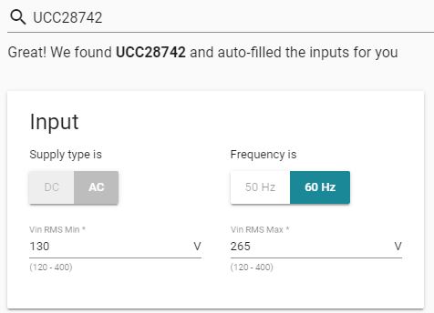

    Will WEBENCH allow the same input votage range and output voltage level on the UCC28742 ?
    I have been using the UCC28742 Design Calculator Tool that was recommended to me.
    The Design calculator is where I came across the not valley switching operation, and was trying either solve it or make sure the design would operate normally even without attaining valley switching.
    Is the Design calculator equivalent to the WEBENCH tool?
    When I try to use the WEBENCH tool with the UCC28742 it pre-fills the inputs and will not let me select DC.
    Also, the voltage range input is very low (400V max) when the Design Calculator lets me enter 1100VDC with no issues?

  • Here is my Schematic currently.
    I believe I may need to adjust some values though.
    Clint
  • Hi Clint,
    Since you had mentioned that you were facing issue creating design for UCC28C42 in WEBENCH, we just wanted to check if you were able to resolve issue in WEBENCH. Apologies for the confusion created.
    Regarding you application circuit design, kindly follow the recommendation as mentioned by Mike and let us know in case of any queries.
    Thanks & Regards,
    Harish
  • Clint
    UCC28C42 is a fixed frequency controller. It does not have valley switching.
    The reason the tool is recommending that the aux winding is that the VDD voltage is recommended to be higher. For example in the electrical characteristics VDD is 25V. The typical schematic that the excel calculator is designing for has a separate aux winding from output (since they are on opposite sides of the transformer) so it calculates an optimal turns ratio. In order to achieve galvanic isolation the aux winding and output winding have to be completely separate from each other. There's nothing in this design so far that would prevent valley switching.
    Eric
