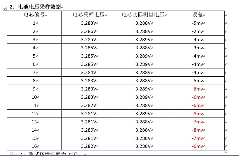

      We use BQ76PL455A to collect voltage,but the sampling precision has large error,the fileas follow:

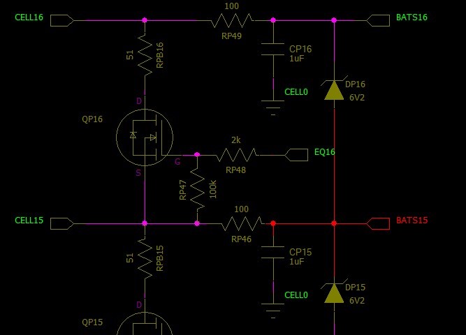

sampling circuit as follow:
  • so additional calibration is required? could you give me some help?thank you~

    Can you provide more details on your design, is the above circuit implemented on a custom hardware design? If so please provide the full schematic. Also, how did you make the measurements for reference? Did you use the GUI vs. multimeter (if so where did you measure this), or something else?
