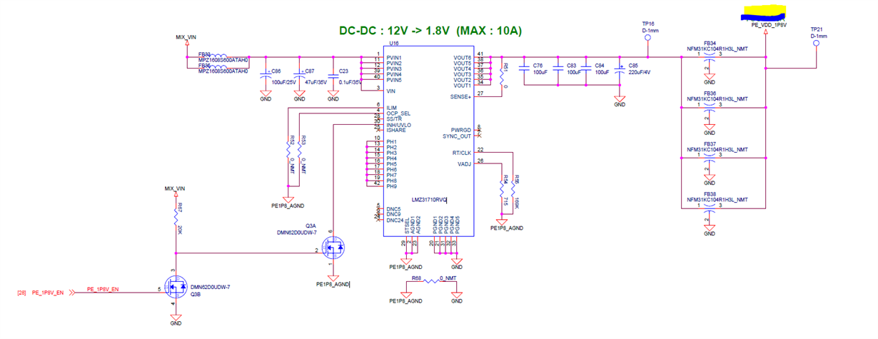

I have used the part LMZ31710 in my boards . But at one of them , the output of LMZ21710 is always about  9V , while the input is 12 volts .
Even the enable net " PE_1P8V_EN" is reset , there is still about 9V on the output where all the beads have been removed .
This part was working well at the start , however , one day , It's been like this .
What factors can make this phenomenon ?
Here is my schematic ,
