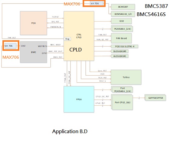

Hi there:
our customer would like to check an application with replace the MAX706 (supervisory circuit); Block diagram as following.
The idea is about using CPLD signal (saying BMC_RST & PHY_RST as example here) to monitor and reset BMC & PHY.
If using our TPS3606-33 circuit, what's the concern need to be check? or any other better solution could suggest for our customer?
Application: Intel server
  • Hi Kay,
    I recommend taking a look at our TPS3705 device before proceeding further. This device is a closer match to the MAX706 and I believe it should be able to fit your requirements. Please let me know if you have any further questions.
    Abhinav.
