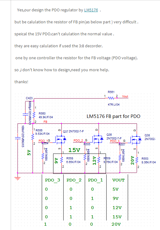

HI,
 our TPS65987D的PDO 4pcs only(5 9 15 20V ),but we need 5pcs PDO(5 9 12 15 20V).
  like this can't matching the PDO pins one by one.
so Eric(TPS65987D FAE) suggest enter TT Mode (true table) for TPS65987D .
it should be get 7PCS PDO controll pins. but didn't answer us,is it by decorder(3:8) or directly for contact the FB resistor(show as below)
could you help me any sugest about it?
  is it by directly (calulation the resistor very difficult for PDO 15V)or decoreder(3:8) method?
thanks!
