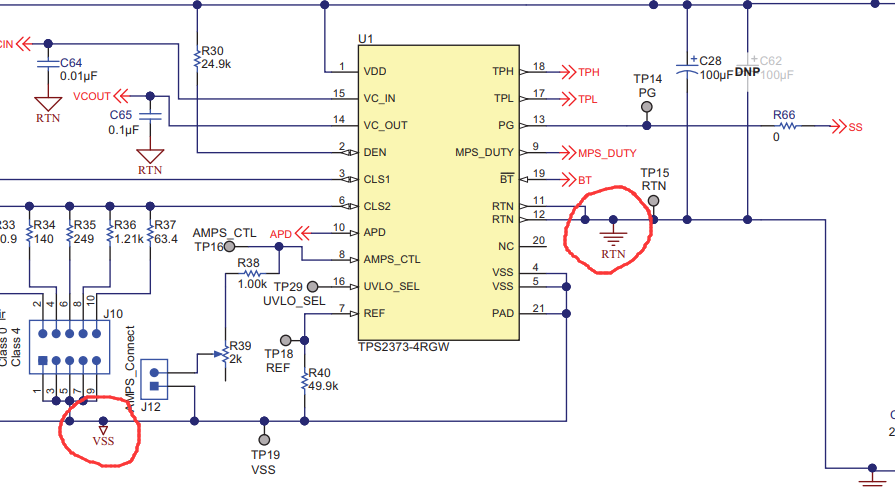

Dear sir:
I have a problem,When the PSE shakes hands with TPS2373 successfully, does TPS2373 turn on a switch to let VSS (4,5,21) and RTN (11,12)
Dear sir:
Hi David,
After negotiation, the PSE will turn ON to nominal PoE voltage (52-57V). During this voltage ramp up, then the voltage goes above the UVLO threshold of the TPS2373 (~38V), the internal pass FET will slowly turn ON. I say slowly because it will turn ON to a inrush current limit to charge bulk cap meaning the voltage between VDD-RTN will ramp up depending on the bulk cap (C28). Figure 17 of the datasheet shows the RTN-VSS behavior. Thanks!
