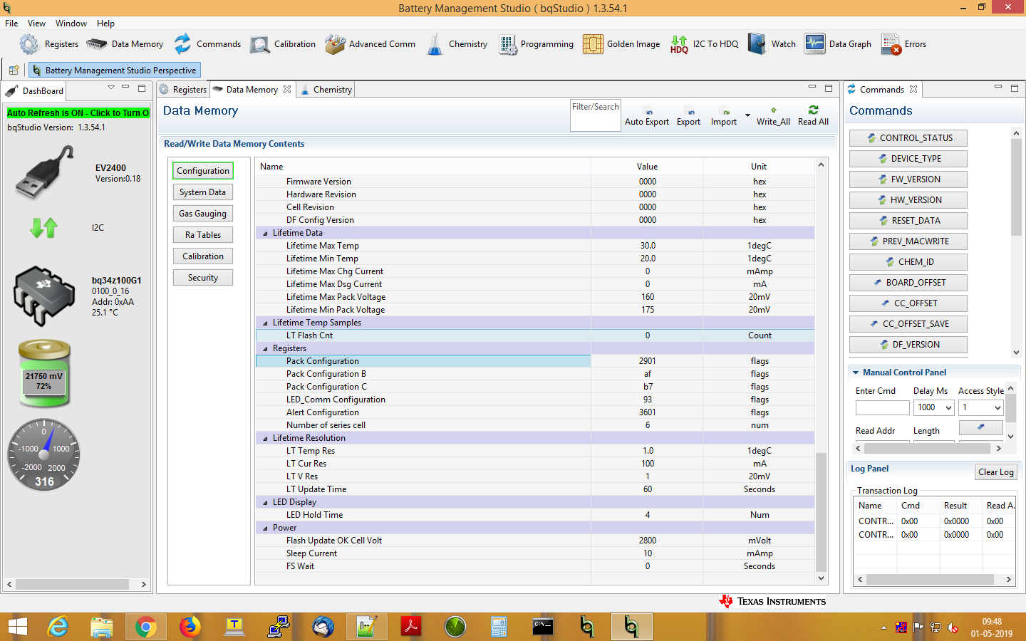

These are the following configuration I have done on eve board for 6s1p cell.
Design capacity : 2600mAh,
Design Energy : 2600 * 3.63 = 9438
Pack configuration : 0x6901
Pack configuration B : 0x0f
pack configuration C : 0xb7
No of series cell : 6
I got 100% SOC on 25.08 which I was supposed to get on 25.2 and SOH was 99%.
I generated golden file with above setting and firmware used for bqstudio is 0100_0_16-bq34z100G1. bqstudio version 1.3.54.1.

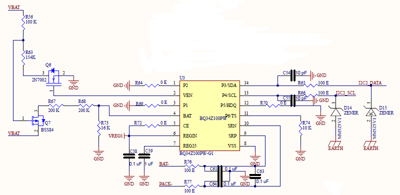

Same golden file I programmed on our design and Chem ID 1165. But I am not getting SOC value and temperature(external) is showing around -39.2"C.
What could be the issue, Its a design fault , Chem ID is different or some other issue.
Kindly provide your input to solve this issue.

  • Hi Shailesh,
    What is R74?  Is it a 103-AT thermistor?  From the symbol it appears to be a 10k resistor.  Please ensure this is a 103-AT thermistor.
    When designing with the cell on the EVM, did you use the gpcchem tool ( http://www.ti.com/tool/gpcchem ) to determine the chemID?  If not, please do so.

  • Hi Bryan,
    Thank you for the reply.
    There was some mistake in design. As per bq34z100 Eve schematic, I connected TS Pin to REG25 Pin with 10K resister. And there was a resister missing in divider circuit. After all rework I got SOC, voltage and temperature 25.2'C. I selected Chem ID 1165.

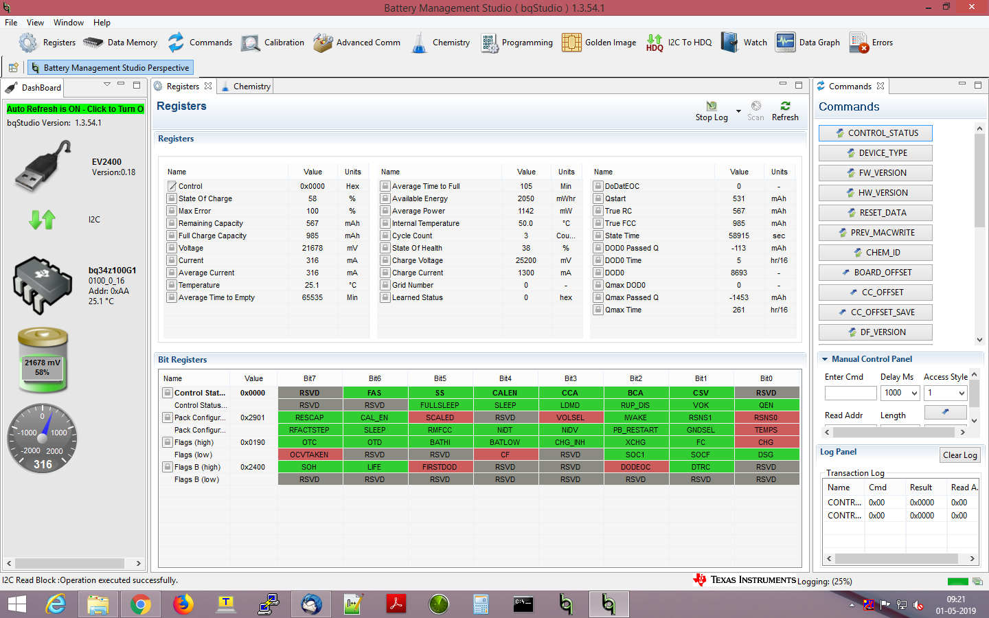

    I have attached screenshot of bqstatus register.
    Do I need to generate Chem ID for this particular cell even it works with 1165(Still I have not done full testing)? Finally I have to write driver with all setting for bq34z100 for our design.

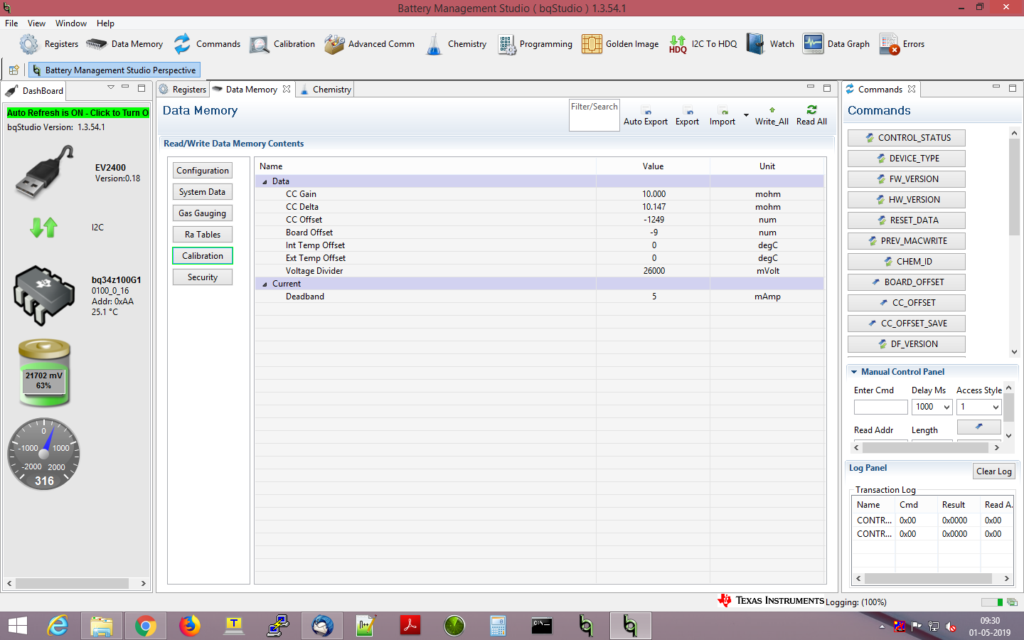

    As we can see in snapshot Max error is 100% which I think it should be less. I tried to calibrate Voltage and current but I got error like out of range data. I have gone through the above article of voltage and calibration.

  • Hi Shailesh,
    Please update bqStudio to the latest version, 'bqstudiotest' found here: www.ti.com/.../bqstudio This will fix the out of range issue
    With respect to the chemID, use the gpcchem tool to determine a match, program that chemID into the device and then run a learning cycle.
