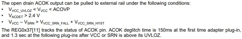

    Section 7.3.1.2 of the datasheet lists the conditions that cause ACOK to be pulled up to the 3.3 V rail:
    Can you please provide a table with the following voltage measurements: ACDET, ACOK, VCC, VBAT, SDA, SCL, PROCHOT, and REGN? These measurements should help provide insight on why ACOK is not going high.
    Angelo

  • Hi Anandan,
    Is REGN still 0 V, as you said in your original post? If so, then that's very unusual because the conditions to enable the REGN LDO are that ACDET > 0.6 V and VCC > UVLO, which are both true according to your table.
    Please describe your test setup in as much detail as possible so I can try to duplicate this issue on an EVM. A screenshot showing all your register settings would also be helpful.
    Angelo

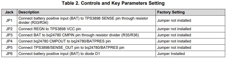

    We are using BQ24780S EVM for charging our battery. The 3V3 supply and 19V board supply is given through power supply. The Jumper setting we have done is that JP6, JP1, JP2 are closed using jumper and JP3-Pin-01 is grounded through wire since we did not use comparator input pin. The Same is done in our EVM Boards used for testing. All are working properly But one board Seems to be odd.

  • Hi Anandan,
    You can try again with the jumper settings given in the EVM User's Guide. However, if you're using the same test setup for all your EVMs and only one of them exhibits the issue, then it's likely that the IC was somehow damaged.
    Angelo
