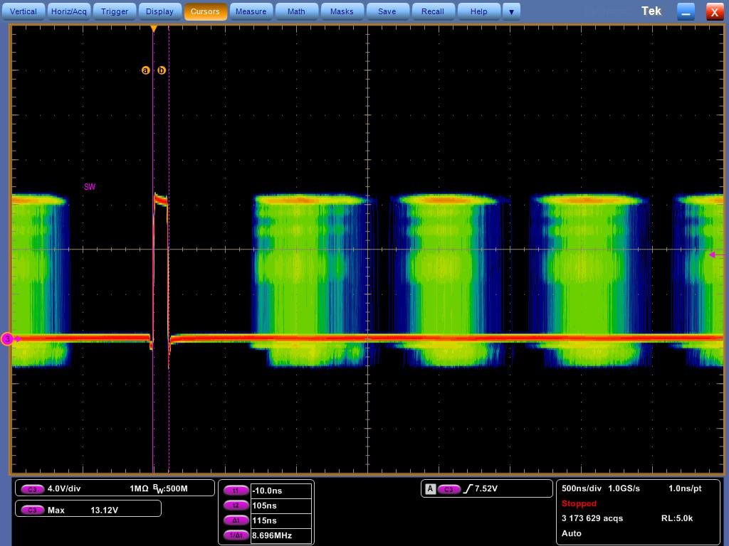

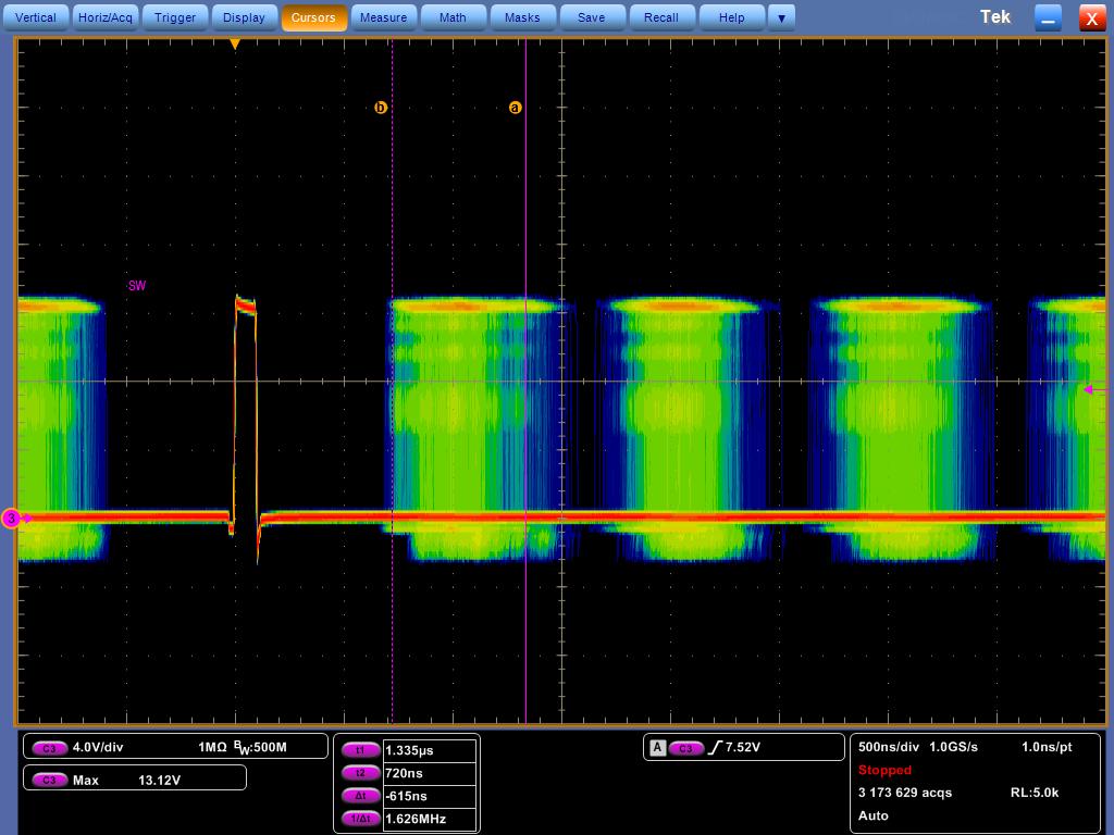

Dear Sir,

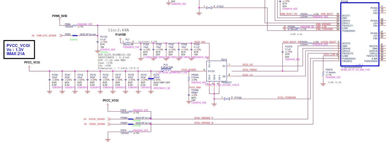

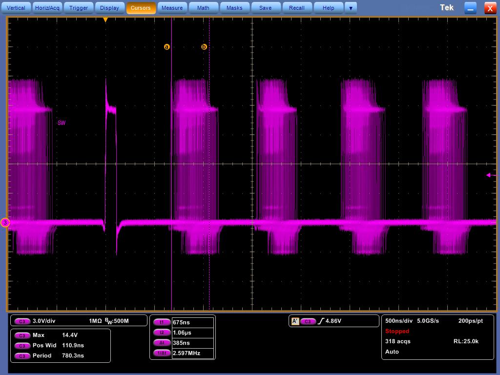

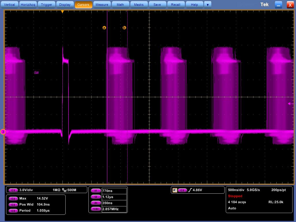

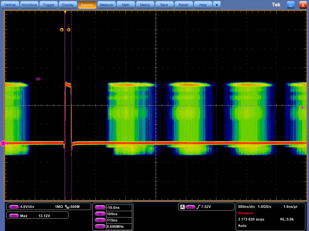

I am Alec Chen form WT and our customer is currently using TPS650942 in their design(please see the schematic as below). And we discover that the Jitter for the Buck 2(VCGI) power rail is over RD's spec (within 25%) . Please also see the Jitter waveform that we measure shown as below. The first one is the 4A load waveform and sec one is the 21A(max load). We check TPS650942's spec and it seems that there are not much that we can change to improve the Jitter . Therefore , Could you kindly give us some advice about improving the Jitter issue? Thanks in advance

  • Alec,
    Are the lengths of these pulses actually changing or is only the frequency changing? It looks like only the frequency is changing, which wouldn't make sense if the load was 21A. If you try putting the BUCK in forced PWM mode does this go away?
  • Dear Jack,
    We did double checked when we measure the wavform, it is not frequecy changing and it is the COT mode Jitter. we make sure that the PWM is out of low-load skip mode(that is why the first waveform is 4A load). We will try to use "forced PWM" mode and see if there is any improvement. and also, please kinldy let us know if there is a any other solution that we can improviee this jitter issue(RD can't go on the next stage testing without fixing this). thanks in the advacne

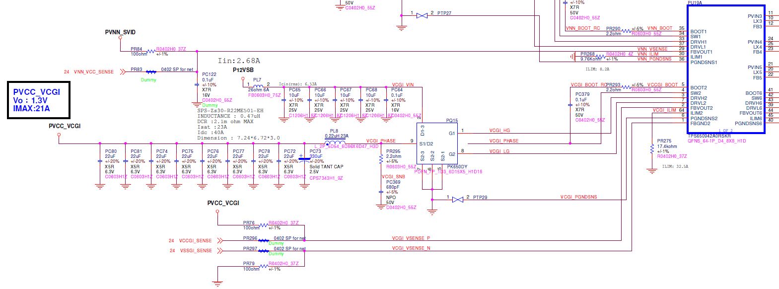

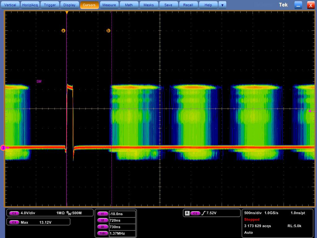

    We have checked the forced PWM mode for the VCGI as you suggested and it seems no improvement or the Jitter. besdie that, we also mearure the VNN power rail and it seems also have large Jitter as VCGI power rail, please the schemaitc and waveform as below. please kinldy guve us some suggestion about impvoin ghte Jitter issue. thanks in advacne

  • Dear Nick,

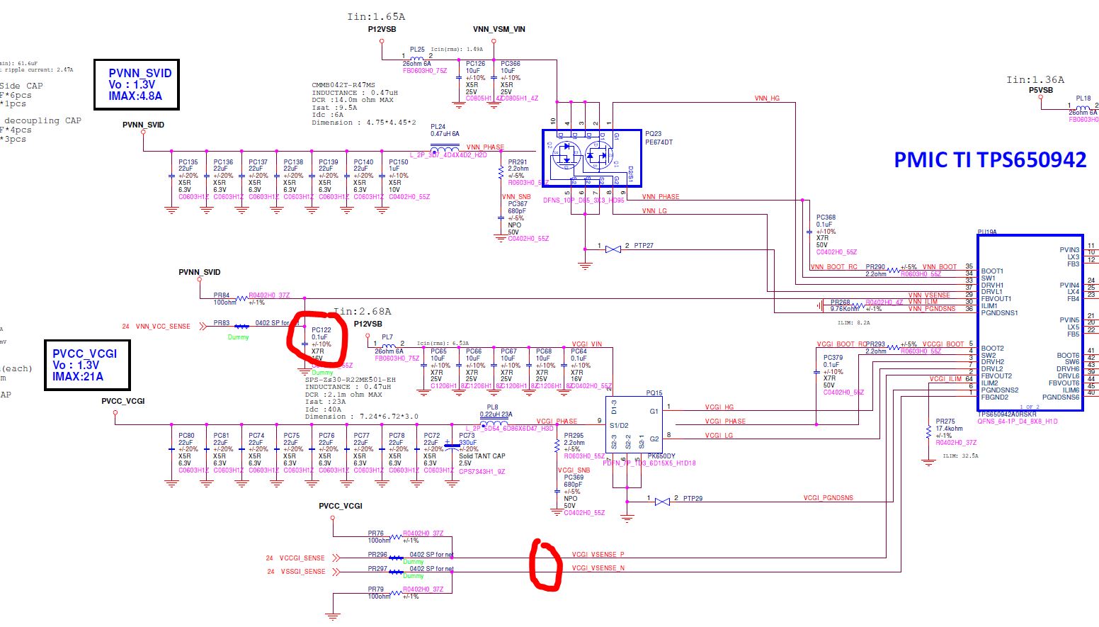

    We have visited RD for the Jitter issue and it seems the solutions that we suggested didn’t improve the Jitter and here are the solutions that we have tried so far
    1. Change to PFM into the forced PWM mode ==> no improvement for the Jitter
    2. Add a capacitance between the Sense+/ Sense- of VCGI (we tried 0.1nF and 1nF)  ==> no improvement for the Jitter
    3. Try to place PC122 0.1uF on VNN FB pin(we also try 1nF, 0.1nF) ==>  no improvement for the Jitter
    RD would like us to fix this issue soon as we can or it will delay the next built schedule .Therefore, please kindly give us some suggestions soon as you can. Thanks in advance

  • Alec,
    I have looked into this more and I believe that the reason there is this jitter is because the BUCK controllers use the DCAP2 design, which gives the BUCK improved transient performance at the cost of a more consistent switching frequency. As such I don't believe there is going to be a way to get this jitter to go away. Perhaps the customer will be okay with this if they know it is not unexpected behavior?

  • Alec,
    I don't think there is a way to reduce this jitter.
    However, this is to be expected given the design of these BUCKs, and should not be considered an issue. This also should not have an impact on the CPU performance or pose any risk to the power design. The benefit of increased transient response is more important than having a consistent switching frequency.
