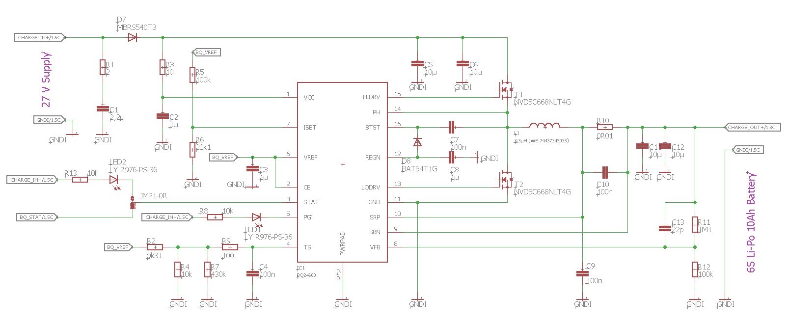

I'm currently in despair with my charger-board design.
First I connected: PowerSupply => Charger-Board => BMS => Battery (6 Cell 10Ah)
Result: Charge-Current 300mA instead the adjusted 3A; BQ24600 was quiet hot.
But PG was blinking and STATE lights.
Then I decided to remove the BMS (maybe would thate be the problem) and connected the Battery directly (power supply removed).
Short Bang and the BQ24600 had died.
I'm confused, I don't know how I can search the mistake - there's no time for meassure... I think there is no error in the circuit - maybe it's a bad pcb-design?
Hope someone have an idea.
Here my EAGLE-Files:
0447.Charger.zip
