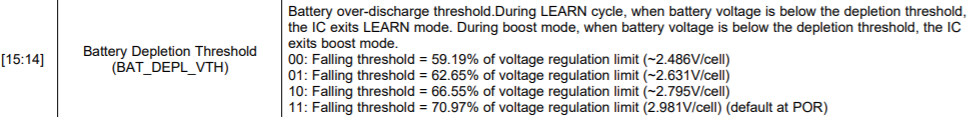

We're developing battery charger. Our battery voltage is 1.5-2.5V, CC/CV mode charging. We've purchase bq24780sEVM. But our battery voltage always below "battery depletion threshold"(ChargeOption1 Register (0x3BH) bit15:14 )
We need a charger IC which can supply 2.5V(Max) 5-10A in CC/CV mode. Please help me to disable battery depletion threshold or find other charger IC.

    Thanks for that information. The BQ24780S will be fine for your application.
    I just want to clear up one potential misunderstanding. The battery depletion threshold is defined as a set percentage of the voltage regulation limit, as shown below. Therefore, as long as you set your charge voltage register setting to 2.5 V, then you won't have the issue with your battery voltage always being below the battery depletion threshold.
    In the picture above, the "2.486V/cell" approximations are assuming that the charge voltage register is set to 4.2 V/cell, which is standard for Li-ion batteries. These V/cell approximations will be different for you since you're charging a lead acid battery with a charge voltage of only 2.5 V.
    Angelo
