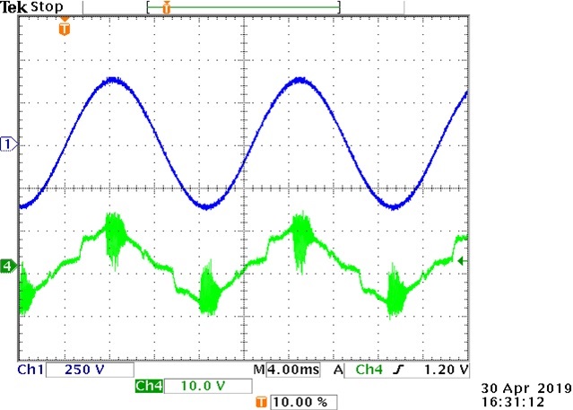

UCC28070-Q1: input current unstable while input voltage is higher than 250Vac
Part Number: UCC28070-Q1
Other Parts Discussed in Thread: UCC28070
We used UCC28070 on traditional boost PFC. It's found that the input current became unstable while the input voltage is higher than 250Vac. That is not related to loading as we changed loading from light load to full load, it is there always. attached waveform channel1 is input voltage, channel2 is input current. Please advise. Thanks.
