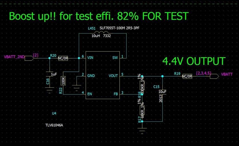

Hi TI,
This design uses a TLV61046A to boost a 3.6V to 4.4V output at 70mA.

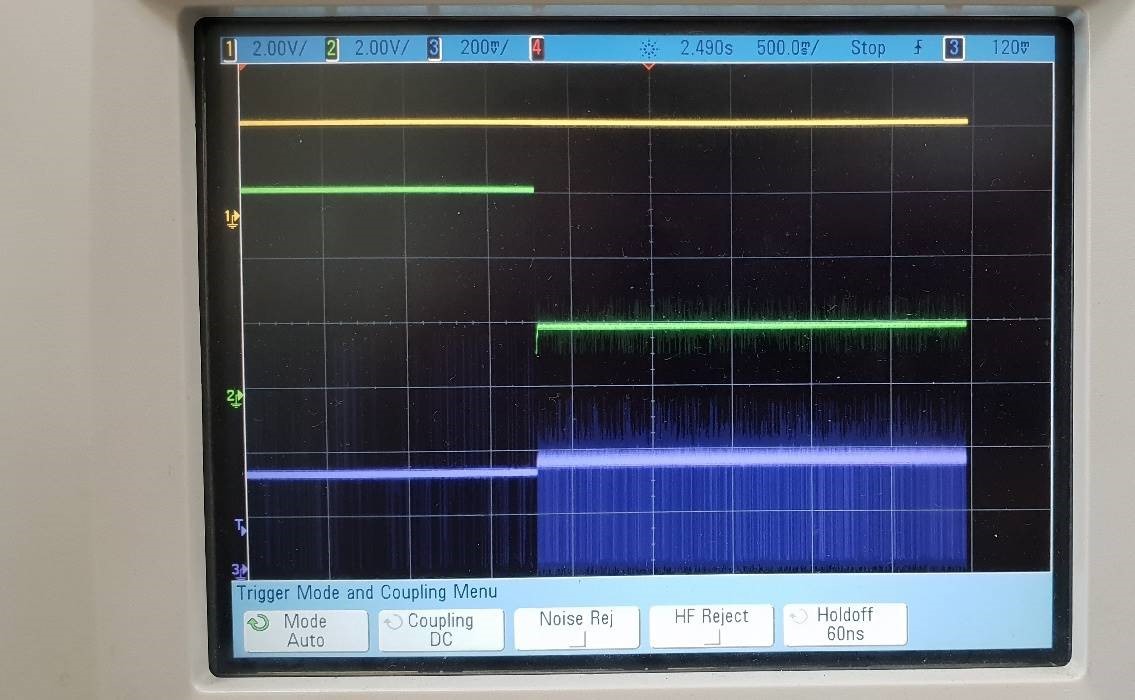

If the regulator is unloaded, it comes up and regulates fine. However, the regulator cannot bring up the 70mA load.
If duty cycle is lower than the minimum on time, output voltage can be dropped?
Datasheet shows the minimum on-time 150~250ns.
