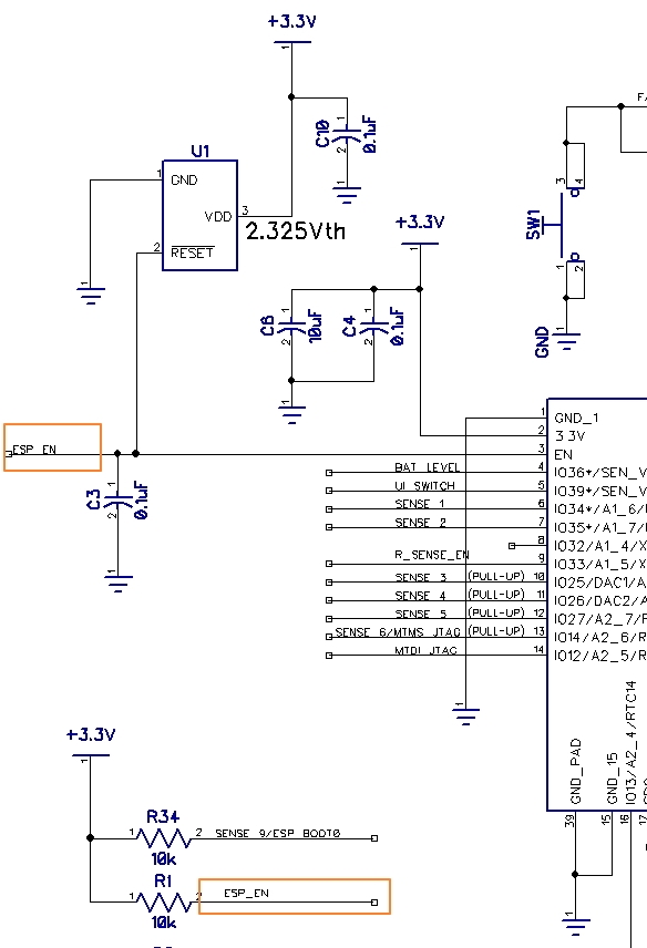

TPS3839: Preventing uProcessor from Disabling
Part Number: TPS3839
I'm using the TPS3839G25 to disable a uProcessor when battery voltage dips below the threshold of 2.325V. The RESET line is directly tied to the Enable line of the uP, it also has a cap, and a 10k pull-up resistor.
When I hook up the uP to the programmer where it's supposed to pull the Enable line low and then back high to reset, it can't quite pull it low enough to disable it when the TPS3839 is in-circuit. I take the TPS3839 out and everything works normally. Not sure what's happening there, any thoughts from the community?
