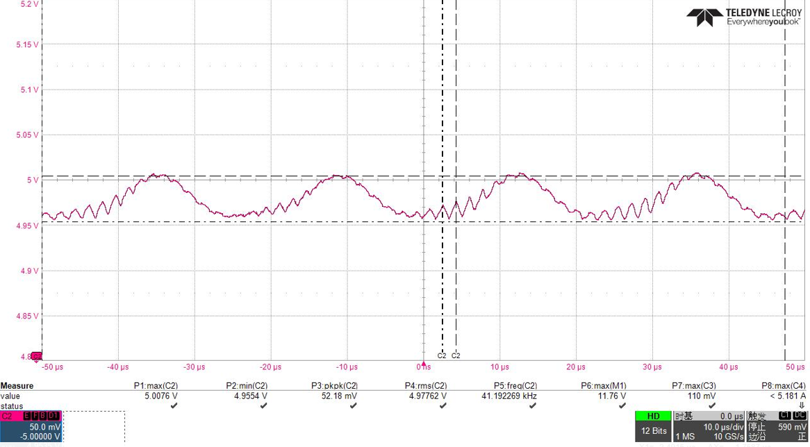

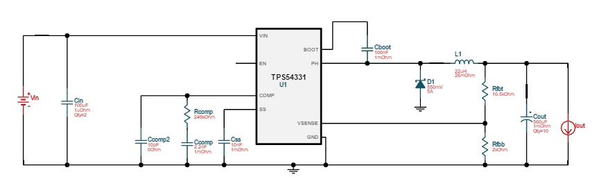

                   The circuit using TPS54331DR as 12V Buck to 5V function as bellow picture
The 5V Vout has about 40KHZ ripple as bellow waveform picture

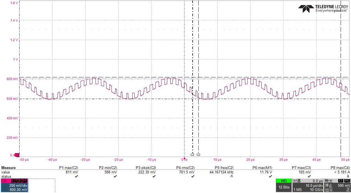

The TPS54331DR Comp Pin6 to GND Voltage as bellow picture
