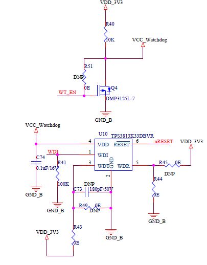

I am Akshay Pathak working as an Embedded Hardware Engineer in Teksun Microsys Pvt. Ltd. I am using Watchdog Timer IC part no. TPS3813K33DBVR in one of my application and I need some clarity for the Schematic that I am working on.
I have attached image file of my Schematic for the Watchdog Timer portion.
In the application I need to set the Timer window of 2 sec and for that I have set the schematic as per the above image. So, kindly review it and Give us more information if you think that this will not be enough for Watchdog Timer IC to work properly.
Kindly let me know if you need more information for the same.

    It seems by looking at your schematic that you are trying to program the window-watchdog using an external capacitor as described in section 8.5.2 of the datasheet. If this is the case, using your 180 pF capacitor at C73, you should not have it also connected to Vdd at WDT. The operation modes are either to ground, to Vdd, or to an external capacitor. Additionally, if you choose to use a programmed option, you must connect WDR to either GND or Vdd depending on what you want your lower window frame to be. Let me know if you need more help on the subject.

  • Hello Abhinav,
    My application requires 2 seconds of timer, so can you suggest what should be done in this as currently I have given every provision possible by using DNP in my schematic so as to not get stuck later if either of the case don't work.
    Also let me know if i will have to change the capacitor value so as to get the 2 seconds in this application.

    I understand that your application requires a 2s Twindow,typ spec. To achieve this, you need to change the capacitor you have included on C73. According to my calculations, you should set your C value to 4960 pF. This does not take into account cap tolerance, so I recommend considering that with the equation in the datasheet if you need a tighter window. In addition, you must have WDR = VDD for this.

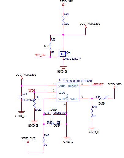

  • Dear Abhinav,
    I apologize if I created any confusion, what i wanted to say is that my device is not waking up as watchdog timer IC resets it in the starting.
    I have controlled the supply of watchdog using Mosfet and i am driving it with my MCU as shown in the below image.
    So whenever i wake up my device and Watchdog gets its supply then it generates reset function in the starting and my device again goes into standby mode, which is a problem as it won't let my device come into normal mode.

    Is your RESET going high and then dropping low? Do you have any scope shots I could see to diagnose why you're encountering this? I'm still a bit unclear on the events. If your RESET is not staying high, it is most likely an issue with the application circuit, but I need a little help understanding what is happening now and what you are trying to accomplish. Scope shots would be very helpful.
