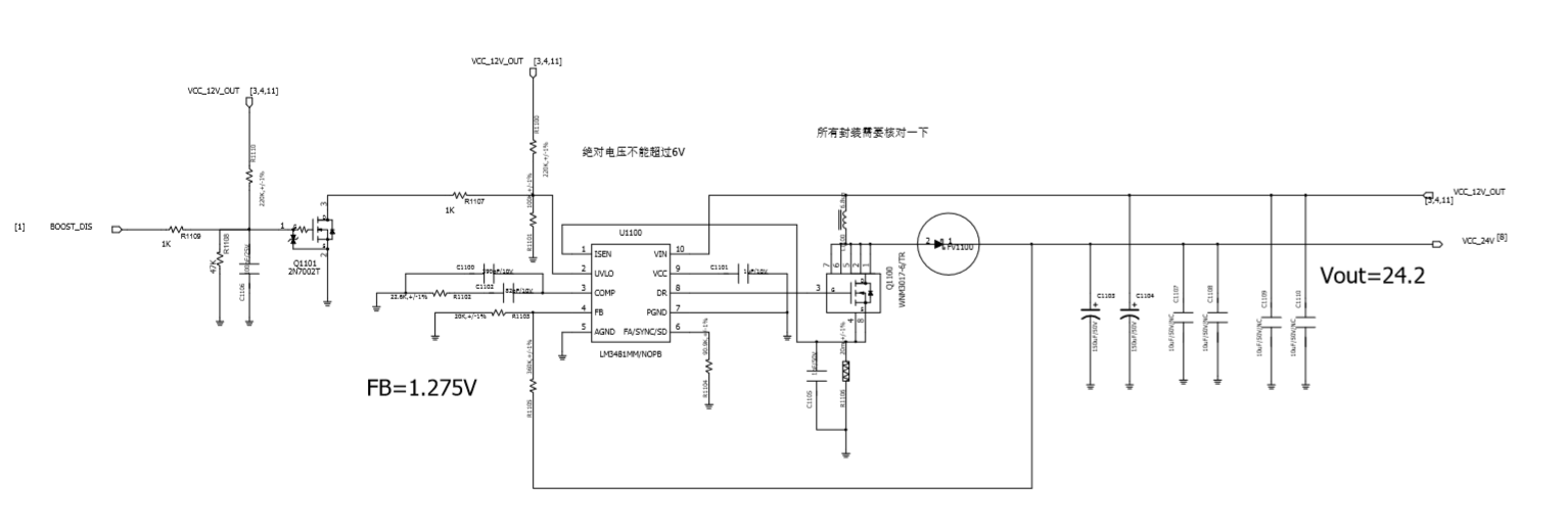

The product I designed USES LM3481,COMP Pin as Compensation Pin,Rc= 22.6k, which is not normal resistance. How is the resistance value set?Is there a formula?thank you.
BR
Sunny
Hi Sunny,
The compensation resistor value can be calculated using the following equation. This is similar to the calculations done in the LM5155 application note for designing a boost controller
Fcross is the desired cross over frequency value and is typically less than 1/5th the right-half plane zero frequency. The value of RCOMP can be shifted to a standard value without having much impact on the circuit.
Please let me know if you have any questions.
