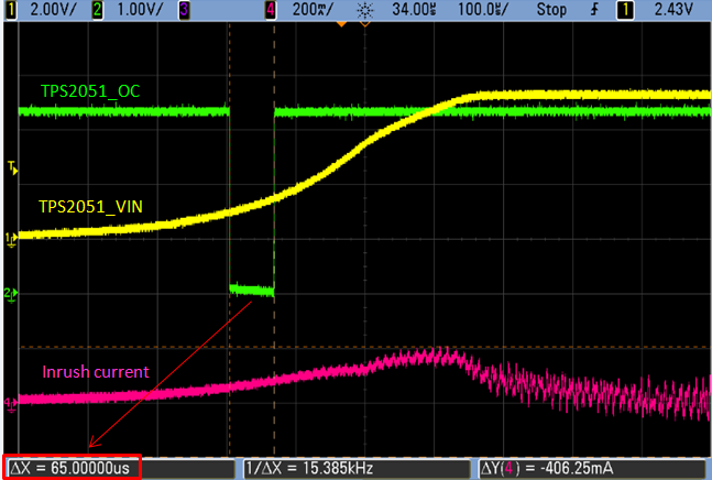

We use TPS2051B. Measured TPS2051B when the power supply (VIN) is started.
OC pin will have 65us low signal. Is this OC pin low level internally issued?
If so, can I ignore this signal? Thanks for help~
