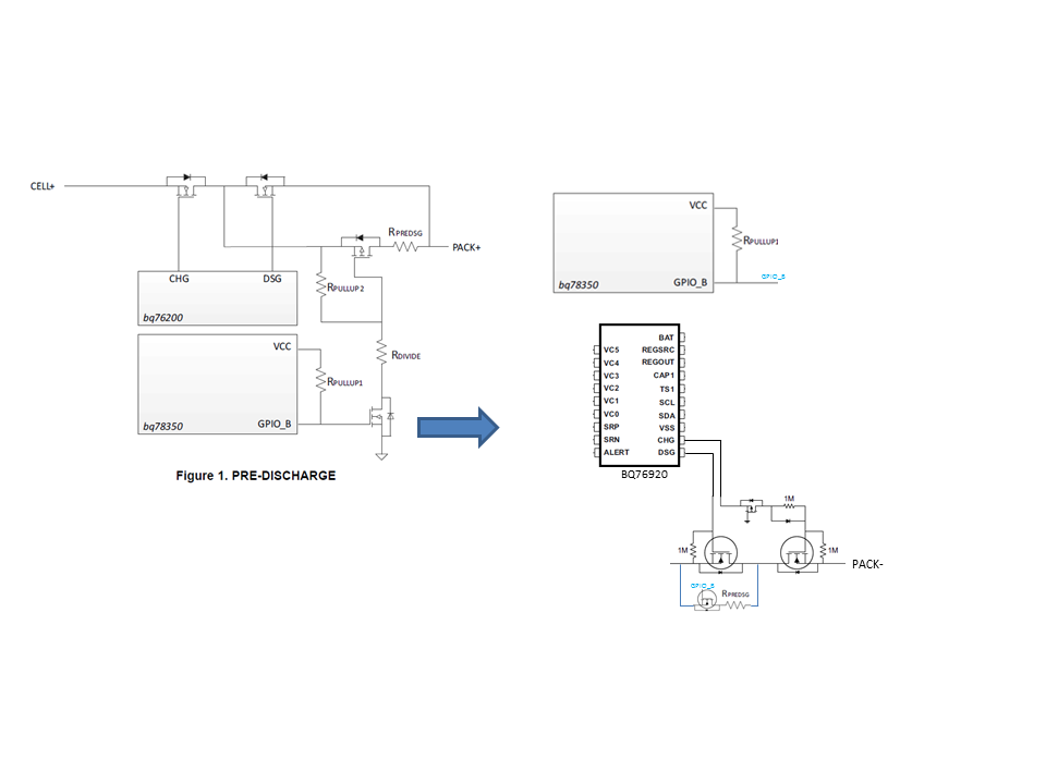

Can I'm using BQ78350-R2 with the AFE BQ769x003 and pre-discharge function on low side (N-FET on PACK-) ?

We do not have an example schematic, but I did a quick drawing of how you could implement this. The right side shows the low side implementation - the BQ769x0 drives the CHG and DSG FETs directly and the PDSG FET is connected across the DSG FET. The gate of the PDSG FET is controlled by GPIO_B.
