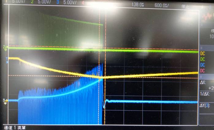

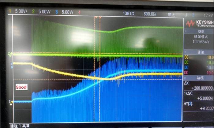

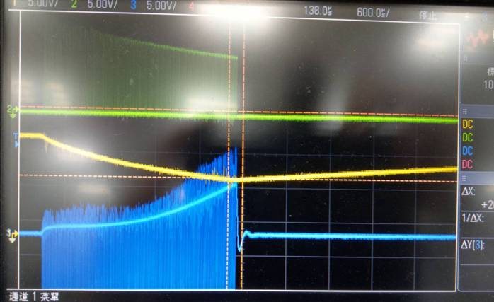

TPS23754 work well in normal temp. condition, but IC can not power on if temp. lower than 0 degreeC,
Then we measure the voltage of Aux. widing:
CH1: Vc CH2: PWM CH3: Aux.Widing
Room temp.
Low temp.

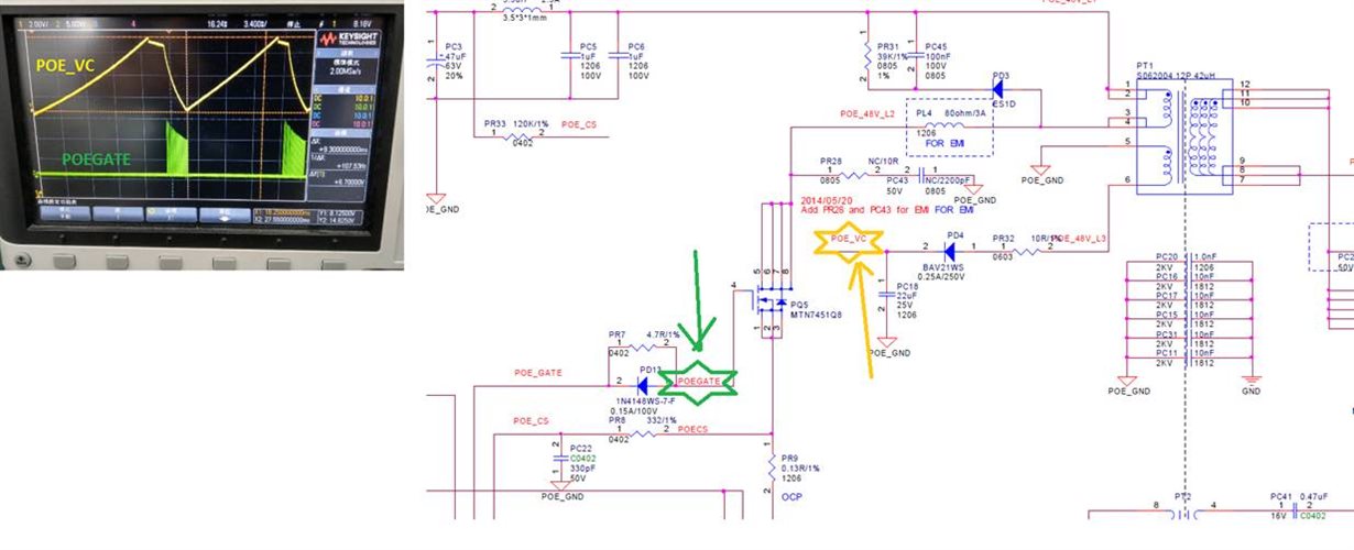

After these testing, we use Cold Spray to check what component can make this issue(IC, cap, diode, resistor, opto-coupler, TL431...), and we found this issue result from TPS23754.
And the issue can be improving by add Vc cap and reduce Aux.widing series resistor.
Could TI help to check that why low temp. makes TPS23754's Vc hard to establish?
Thank you.

  • Hi CT,
    Looking at the first waveform, the VC signal crashes as soon as the FET starts switching. Given this, and that it improves with increasing the cap and decreasing the series resistor, it leads me to believe it might be how Vc is driving that specific primary FET. I have not used that particular FET has we use FDMS86242 in our newer reference designs for this power level. This has 3x less gate charge and 2x less input/output capacitance. I would continue increasing the VC cap if necessary for that particular FET. Thanks!
