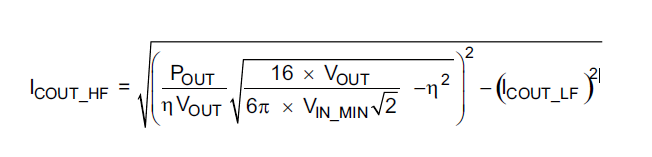

I discovered some difference value in design tool relate to Icout_hf

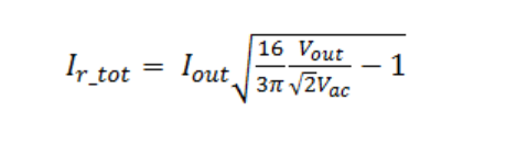

This formula is correct?.. Could you plz check. 6pi  is different compare to bellow formula. (https://e2e.ti.com/blogs_/b/powerhouse/archive/2016/06/14/predicting-output-capacitor-ripple-in-a-ccm-boost-pfc-circuit) Bellow formula is not 6pi but 3pi.  When I use 3pi I can get similar result compare to design tool.
So I think  3pi is correct value instead of 6pi.  Could plz check which formula correct is.

    The document you refer to , SLUA479B,  has an error in the formula for the calculation of the high frequency current.
    You can see this in certain applications  which  will result in a negative number for  the high frequency capacitor current.
    The Excel calculator tool is correct. It uses this formula:
    Please use this formula in place of the formula from SLUA479B
    I am not familiar with the blog you referenced and so I cannot comment on that particular equation.
