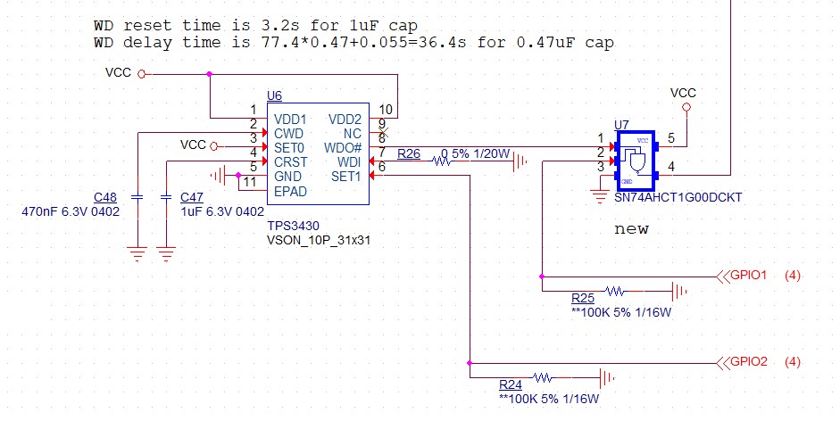

I used TPS3430 in my design, but I didn't find any output from WDO.
I didn't know where was wrong in the design.
Could you help me to review it as below.
PS : GPIO2 is pulled high.
  • Kenny,
    Keep in mind that WDO must be pulled up as it is an open-drain active-low output. Please refer to this section in the pin functions as well as how WDO works in 7.3.3.3 in the datasheet. I don't see a pull up resistor connected on your WDO output.
    Abhinav.
  • Hi Abhinav,
    Thank you so much.
    I added a pull high resistor for WDO, but still no any output.
    After this, I removed the 0 ohm resistor between WDI and GND, and gave a pulse to WDI from GPIO of MCU, the WDO worked.
    So, I think that I can't tie the WDI to ground directly. ( need to pull high WDO first )
