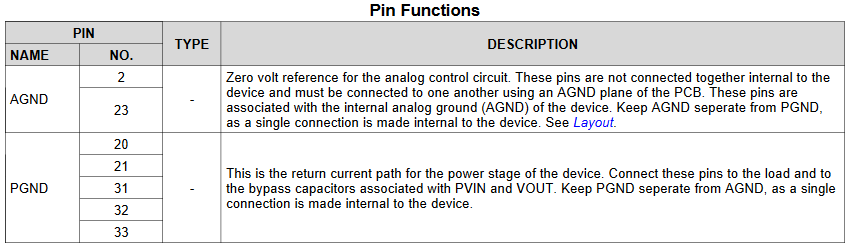

Datasheet says all AGND are not connected so externally it should be connected to AGND plane. is AGND and GND connected internally? or should a connect AGND to GND plane externally using ferrite bead.

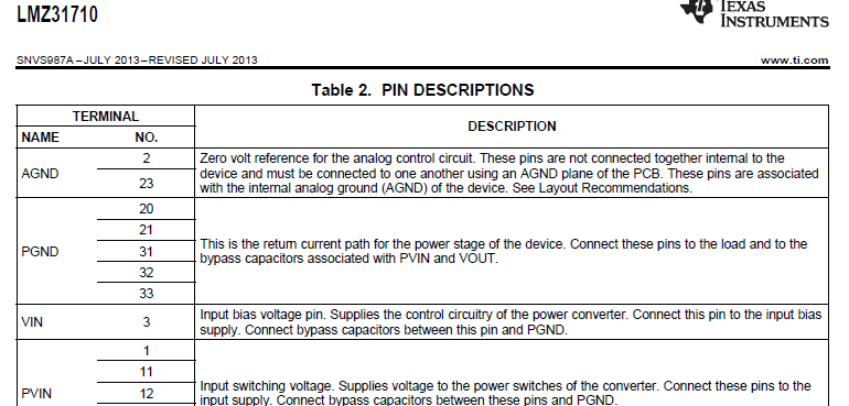

Hi Ajay,
From the image provided you are not up to date with the datasheet. The latest revised datasheet does provide the information. Here is the link to the section in the datasheet in which I was referring to.
