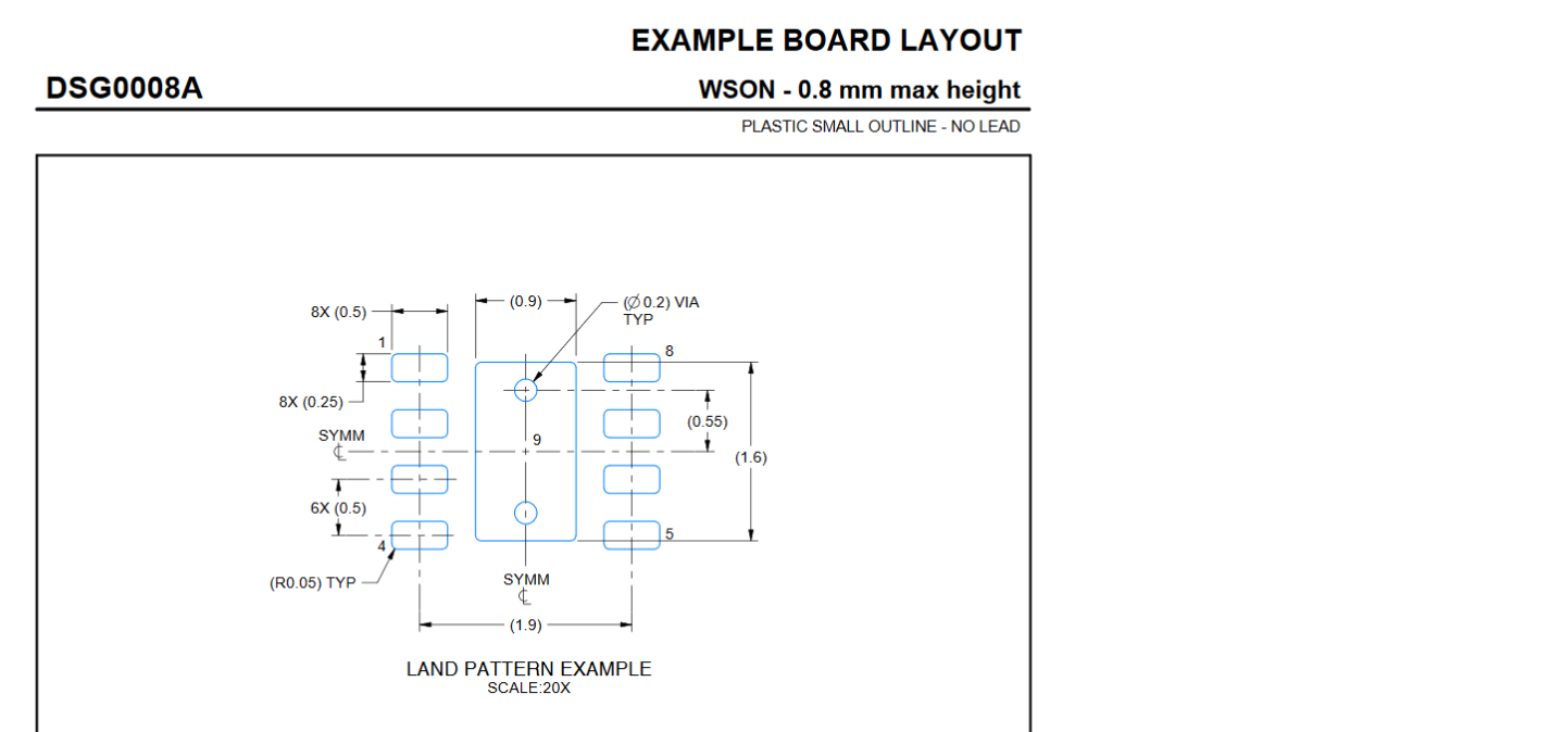

Dear Sir,
TPS3710QDSERQ1 didn't have BOARD LAYOUT Guide.
Please you kindly review & provide data.
My customer waiting this data to do layout.
Thanks!
Steven
Dear Sir,
Thanks!
Steven
Hi Steven,
Unfortunately, this is the only layout resource we have. It provides all the necessary specs for a board layout. Is there any other information you expect to see on that diagram?
Ethan
