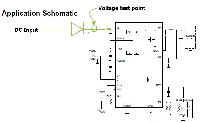

Hi Sir,
         Regarding to the reverse current protection of Charger BQ24160, we try to add diode to prevent this phenomenon (base on BQ24160 reverse boost issue), as follows,
        We found that they have voltage ringing on the Voltage Test Point about the above application, refer to the next figures,
         Figure 1,                                                                                                                                                             Figure 2,
              Could you have any suggestions about this application schematic?

  • Jingle,
    Without a power source at the output (the battery) the IC cannot reverse boost. This IC has forced PWM, which means it does not enter DCM and always has inductor current (even negative) in CCM. So, there will be more ripple than a non-forced PWM buck converter on the input.
    Jeff

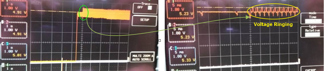

  • Hi Jeff,
                From our test, if no battery and no diode, the input voltage (Charger IN) was stable and no voltage ringing,
                But if no battery and add diode, the input voltage (Charger IN) have voltage ringing,
               Could you explain why use diode is going to have voltage ringing on the input?
    thanks,
    Jingle
  • Hi Jingle,
    Because the charger operates in forced CCM, there is a small amount of reverse current from the inductor that flows back to the input.  The capacitance on the input needs to be large enough to absorb that inductor current.  Without the diode, I suspect that your input source's output capacitance is helping to absorb that current.  Alternatively, you can increase the BQ24160 PMID and/or IN/USB capacitance to prevent the pulsing with diode, but doing so could violate the USB inrush current requirement.
    Jeff

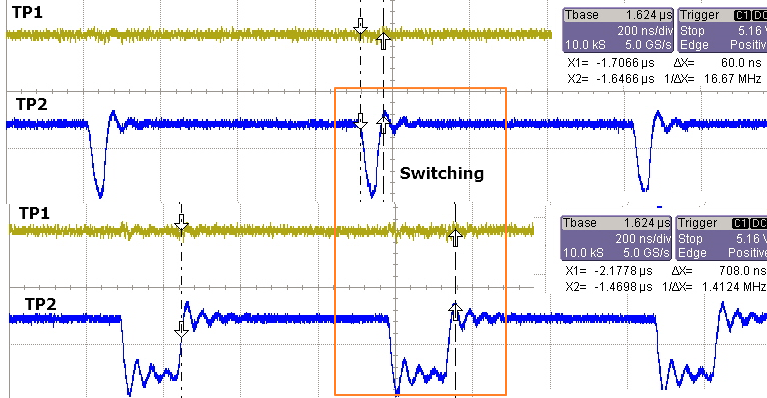

               Thanks for your quick reply, we do some testing about that application schematic (No Battery and have diode), as below,
               1. Using AC to USB adapter to supply to our device (Only USB Power, No USB signal), the charger output voltage is stable and our device is working properly

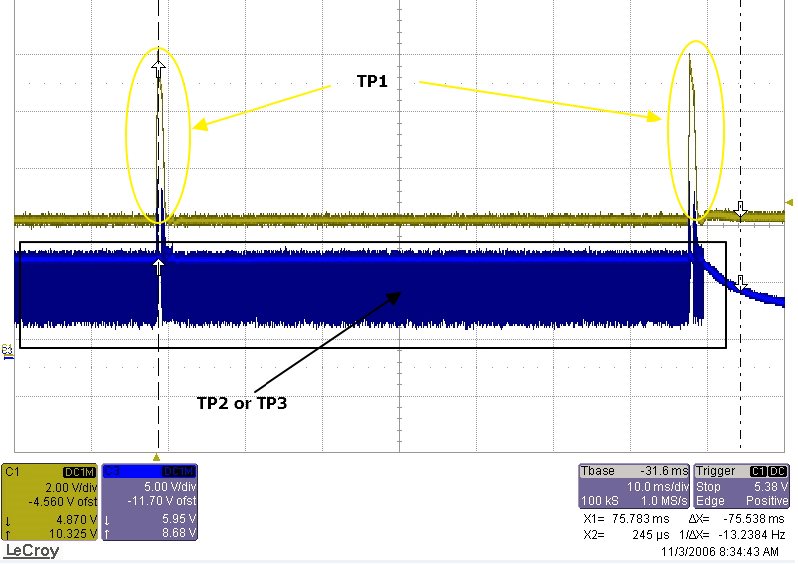

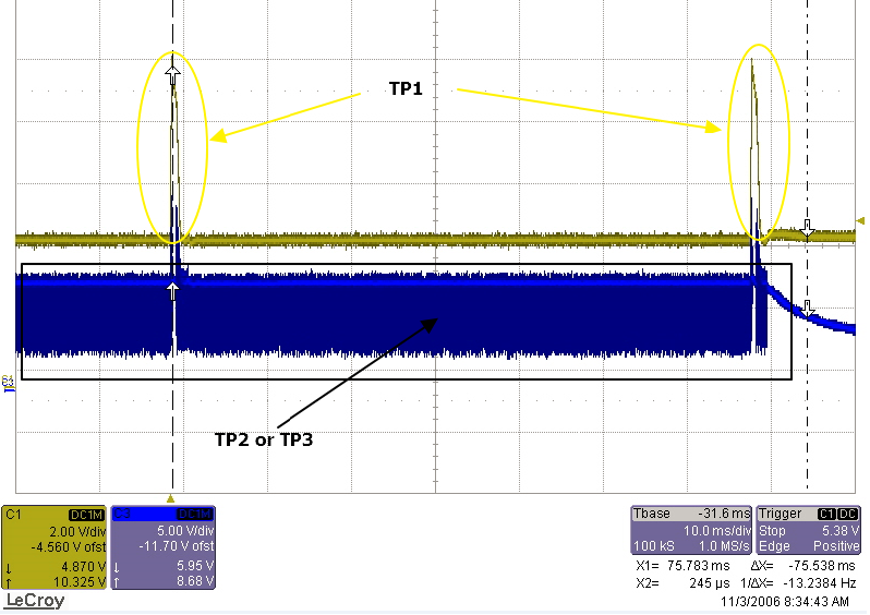

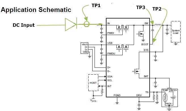

               2. Using DC Power Supply (Model: Tektronix PS280) to supply to device, we found that the charger output voltage isn't stable, we check some pin behavior of the charger, please see the next,
                      A, Test Point figure, TP1 for IN pin, TP2 for Boot pin, TP3 for SW pin,
             B, TP1/TP2/TP3 figure
          C, We add 220uF to the IN pin, the TP1 voltage seems to be smooth(PMIDI is similar to TP1), but the charger output voltage isn't stable, we found the TP2 (SW2) switch in different frequency
                (Working device frequency or PWM/Duty is 708ns stable, not 60ns, and NO switching )
           Base on the above test, the charger seems to do re-boot constantly when the frequency switching, just only add diode into the IN pin,
           The TP1 diode are directional, why to use the diode and DC power supply have to produce incorrect PWM output in the SW PIN?
           I guess it should be dependent and is it possible to have a relationship between the frequency and the internal setting procedure of the charger?
    Jingle
  • Jingle,
    The last plots looks as if the charger is running in max duty cycle mode. Is that plot with both 220uF at TP1 and the diode?  What is the voltage at the IN pin?
    Jeff

  • JIngle,
    I am not able to reproduce your exact waveform but I see some odd behavior with the diode and additional capacitance on IN. When I enable no battery operation (reg0x01b0=1), which disables reverse boost protection, the odd behavior goes away. It appears that the reverse boost protection circuit is not compatible with the diode and additional capacitance. So, I cannot recommend adding a series diode for this device. With reverse boost protection disabled and the diode, there is a risk of boost back.
    Jeff
