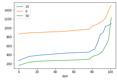

I’m using BQ35100 with a Li-SOCl2 non rechargeable cell with the intention of using EOS mode but I’m having trouble of reading successfully the SOH.
Using bqStudio, I’ve successfully configured the BQ35100 for EOS mode (GMSEL1:0 = 0x2), calibrated the voltage, the current, the temperature and the CC offset. I’ve also programmed the chemistry ID for my type of cell which I think is the correct one.
After the setup process, I’ve removed the BQ35100 from bqStudio to an external mcu to perform more tests, namely discharges and readings.
Starting with a fresh battery and sending the NEW_BATTERY command, every time I perform a reading (as referred in 8.2.2.2.1.2, SLUSCM6D), the SOH drops 5% each time. With this, the SOH goes from 100% to 0% to quick not corresponding to the real condition of the battery.
The 5% percent drop value is related to “State of Health Max Delta” that was configured earlier using bqStudio but I do not understand why the BQ35100 is considering that every time I perform a reading the SOH decreases “State of Health Max Delta”%.
