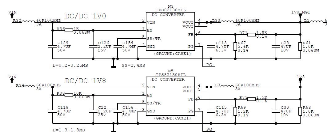

Dear TI Community,
we use the TPS82130 in some designs, but now we face a new problem. The EN pin have a low input resistance (50-100R) all of a sudden on some parts.
The EN pin is connected to VIN with a resistor (10k) and a 100nF cap to GND. There are different values to achieve the right power up sequence.
Good devices have 12V on the EN pin after power up, bad ones less than 0,3V.
Do you have any ideas?
