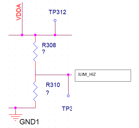

what's the value of resistor devider to limit bthe input current at 4A?
VILIM_HIZ = 1 V + 40 × IDPM × RAC
IDPM=4A
RAC= 0.01Ω
VILIM_HIZ= 1+40*4*0.01=2.6V
value of R310 & R308?
IDPM=4A
RAC= 0.01Ω
Hi Joel H
the input and output voltage of the BQ25703A in my application is 5V
