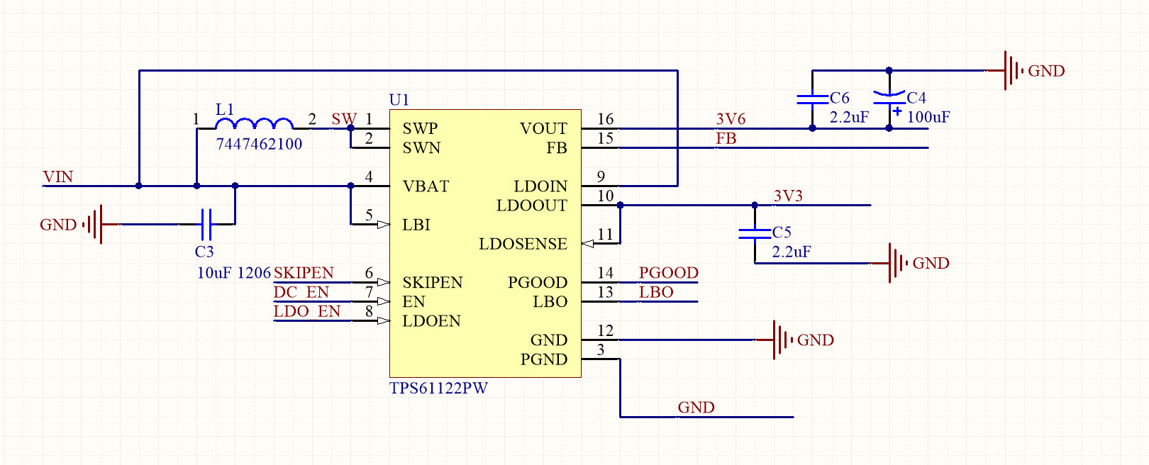

TPS61122: Short-circuit when connecting SWP
Part Number: TPS61122
Dear TI-Team,
I'm prototyping with TPS61122PW but as soon as I connect SWP to the inductor I get a short-circuit.
The schematic is very simple, I guess:
w/o SWP connected and VIN = VBAT = LBI = SKIPEN = EN = LDOEN = 3.3V I see an average current of between 1.3 and 2.5 mA
Any help, please? I guess I have a wrong connection, but I can't see it
