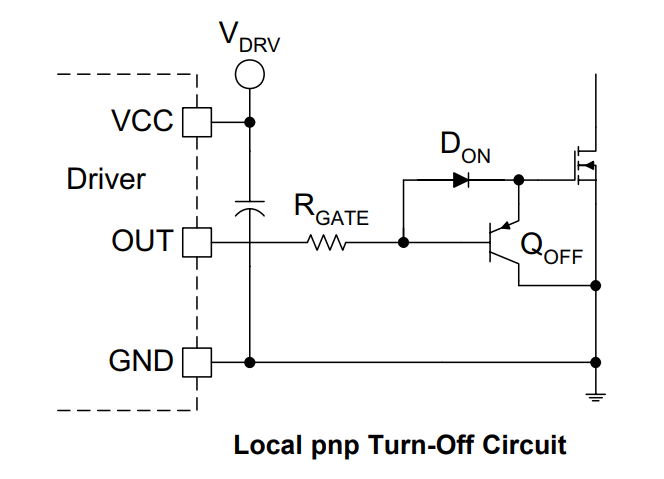

    -From your description mentioned that you're using a 1.5-Ohms gate resistance, from the power dissipation formula of our drivers, P ~= 1/2 * Qg * Vcc * ƒsw * [ { 1 / (1 + Rgate) + ( 2 / ( 2 + Rgate) } ]. You will notice that a higher gate resistance will reduce the power dissipated at the junctions of the driver at expense of slower rise/fall times.
    -You may also further reduce the power dissipated within the driver by using a local pnp turn-off circuit at gate to confine the turn-off current to a small area. This would reduce the total power dissipated by a factor of 2 since the turn-off current never goes back to the driver.
    Please let us know if you have further questions or press the green button if this addresses your question.
