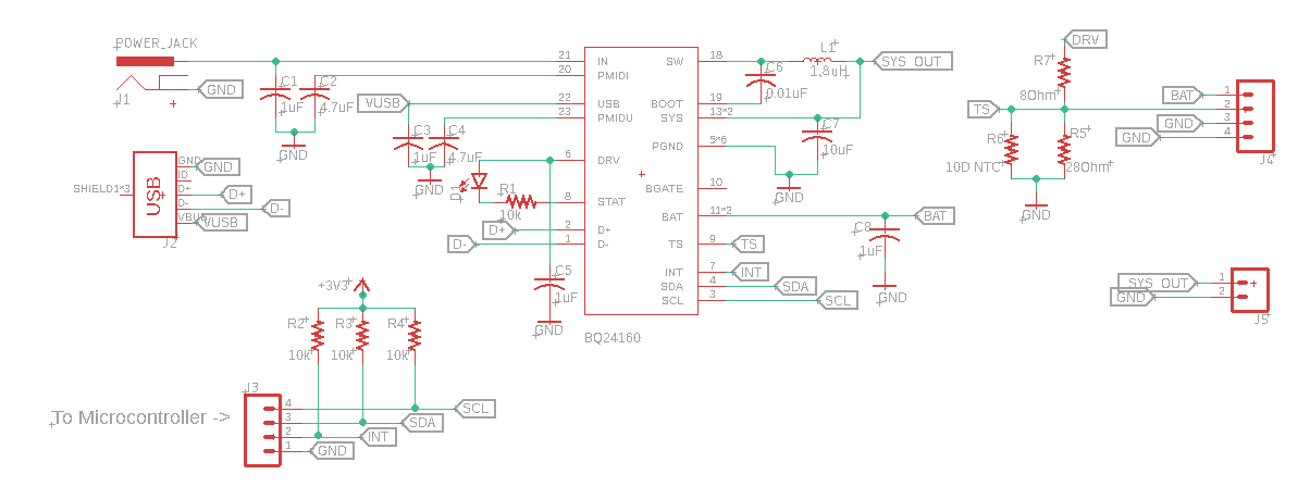

I'm using BQ24160(Not BQ24160A) to charge a 18650 3800mAH battery. I have not connected any of the I2C pins, to anywhere. Not even pulled up.
I'm also not using a external discharging FET.
A thermistor is added to the circuitry with the calculated resistor divider circuit.
I'm supplying 5V 2.5A to IN.
Once a battery which has a higher voltage than 3.6V, the SYS output gives the battery voltage and once it goes lower than 3.6V, IC regulates the input voltage to around 3.7V as the usual default mode characteristics.
But the battery is not appears to be charging. I'm using my laboratory power supply to give mentioned voltage above( 5V 2.5A). The circuit only draws around 10 to 20mA when a load is not attached  to SYS output and only a battery is attached to the BAT output.
My problem is where have I gone wrong and what can I do to make the battery charge.

  • Hello Jeff,
    Here are my register values. And also I have attached my schematic diagram for the reference(CD pin is attached to ground).

  • Kasun,
    The registers report VBATREG=3.6V so the charger will not charge if the battery is above 3.6V. Also, on the schematic, your TS pin resistors are very small. What is the 25C value of the thermistor? The DRV pin can only provide 10mA. What is the DRV voltage?
    Jeff
  • Jeff,
    My battery voltage is 3.4V
    Thermisor 25C value is 10 Ohm
    and with the thermistor and voltage divider connected, DRV voltage drops to around 0.9V
    Thank you
    Kasun
  • Kasun,
    The DRV pin is the output of the linear regulator that powers all of the IC circuitry.  It can only provide 10mA.  Its normal output is IN/USB up to 5.45V max.  Your thermistor is not compatible with the charger (or any of TI charger's ) TS pin.  The thermistor needs to be >1kohm.
    Jeff
  • Helo Jeff,
    I used a thermistor which has 10k at 25C, with a calculated voltage divider.
    Now the circuit started functioning properly.
    Thank you for your help.
