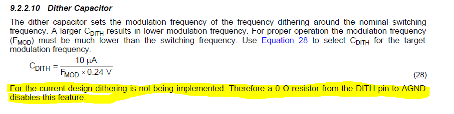

Hi ti team
     Could you pls help us check that  LM5175 dith pin can connect cap ,below datasheet said is not being impletmended.thanks!
  • Hi Jimmy,
    It refers to the example circuit showing in Figure 24, in which the dithering is not implement, so the pin must be grounded. If you want to enable the dithering, you will need to install a capacitor. Please also refer to the EVM schematic where the dithering capacitor position is reserved and you can enable or disable by setting the three-way switch.
