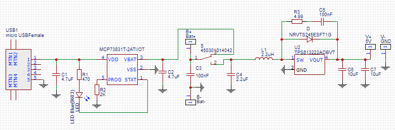

I have designed the circuit and 2layer PCB below for charging and boosting the output of a LiPo battery from 3.7V to 5V.
I am using the TPS613222ADBVT chip to boost the LiPo output from 3.7V to 5V.
When the switch is set to boost mode (disconnecting charge circuitry), I am getting 5V at the output as expected.
However, the board gets very hot in less than a minute. The inductor in particular gets extremely hot.
Can someone please tell me if this is normal, or if there is something wrong with my circuit that is causing it?
Is there any method to dissipate some of this heat without enlarging the footprint of the PCB too much?
Would more vias to the ground plane on the bottom layer help?

    The inductor is a Bourns SRP2512-2R2M (2.2uH, 2.1A current rating, 3A sat current, 104mOhm DC res). Very similar spec to the inductors recommended in the TPS61322 datasheet.
    The capacitors I'm using are all 0603 size and X5R as reccomended in the datasheet.
    The Schottky Diode is the On Semi NRVTS245ESFT1G. Would making the capacitor in the snubber circuit larger make any difference?

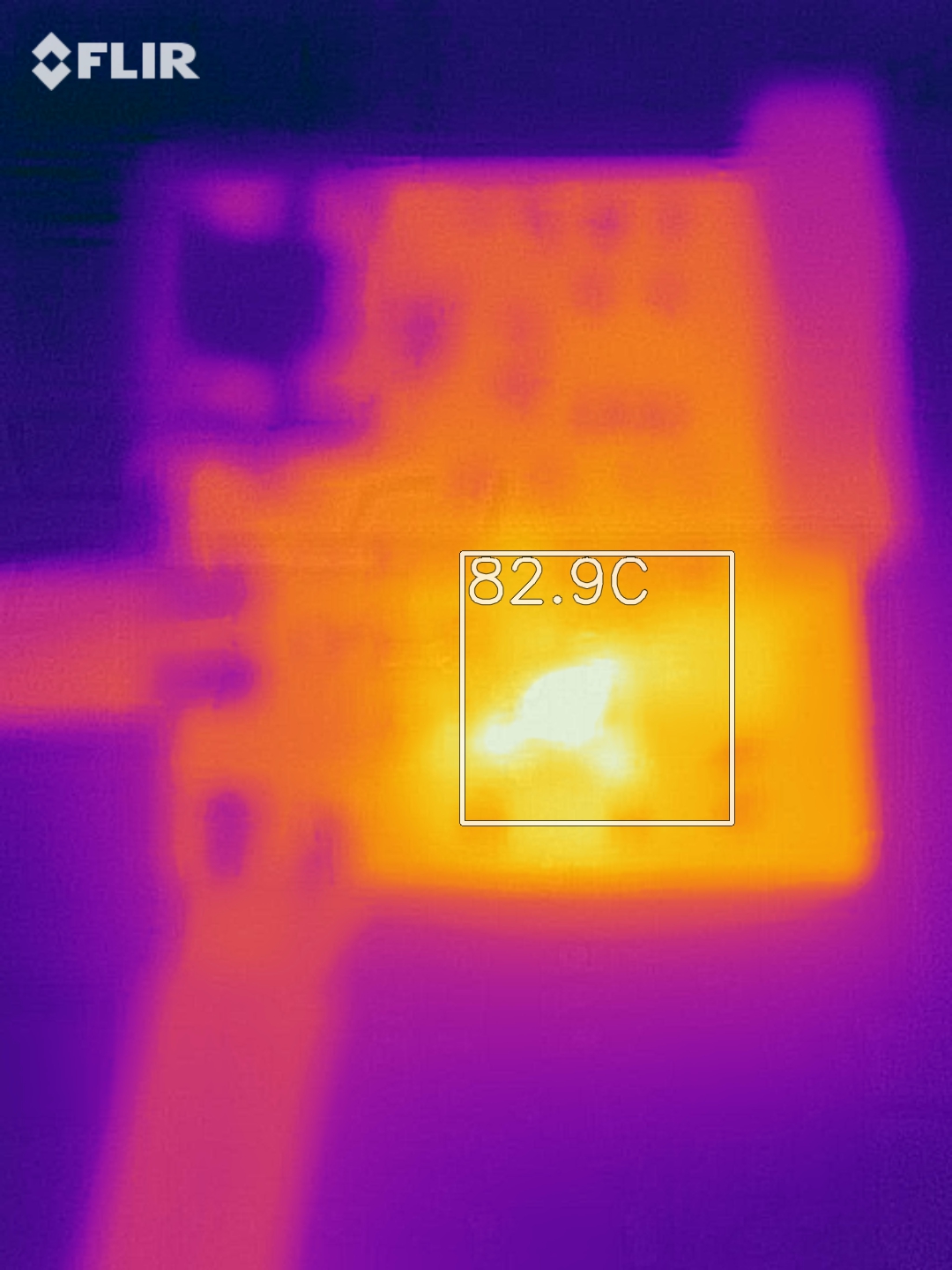

  • Hi Minqui,
    I got a thermal camera to look at the board look accurately. Turns out its the snubber circuit causing the heating. In particular the 5Ohm Resistor I think.
    With the R = 5Ohm and C = 100pF values (which are suggested in the datasheet), the temperature rises above 80degrees as seen below.
    I swapped those out for R = 470Ohm and C = 2.2uF (just because I had those values lying around). The board stayed below 25 degrees and I got a clean 5V output.
    I also tried removing the R and C, just leaving the Diode. And there was no heating issue. The board stayed below 25 degrees and I got a clean 5V output.
    I also tried removing the R, C and diode. The board stayed below 25 degrees and I got a clean 5V output.
    Can you please tell me which situation is best? As from what I saw, all gave similar results.
    With the diode and snubber circuit, the output is slightly lower (4.97V). Without it, the output is slightly higher (5.02V).
    As I need a very small footprint, I would prefer less components. So if the output is a clean 5V and there's no heating issues, why shouldn't I just remove the Diode and Snubber circuit?

  • HI Mark:
    For the snubber, we have a application note about it. It may help you to understand it better.
    www.ti.com/.../slva255.pdf
    For TPS61322, what's your load condition? If the load is light, then you could remove the snubber and the diode.
  • Hi Minqiu,
    The 5V output is powering a TI ADS1299 chip.
    It's does not draw that much current. Do you think it would be ok to remove the snubber and diode?
    Mark
  • HI Mark:
    It's ok to remove them, just take care about the thermal solution.
    The purpose why we recommended adding the diode and sunnber is mainly for the large load with high Vout.
