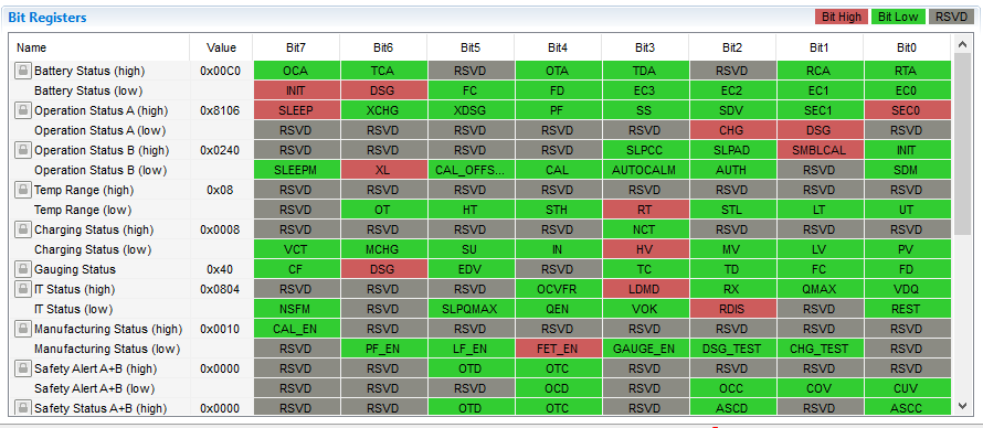

I am using bq27750EVM-837 to monitor my battery behavior. I also use bq27gdk000evm to speed up building my experiment.
I meet a problem that after I setup the hardware connection and set all the parameters I need to gauge data memory, I am not able to start the discharging procedure from bqstudio by clicking start button under GDK tab. It gives me an error message. I am sure I have enable the FET.
Could you give some advise?
I attach the screenshots of register contents, discharge information and error message.

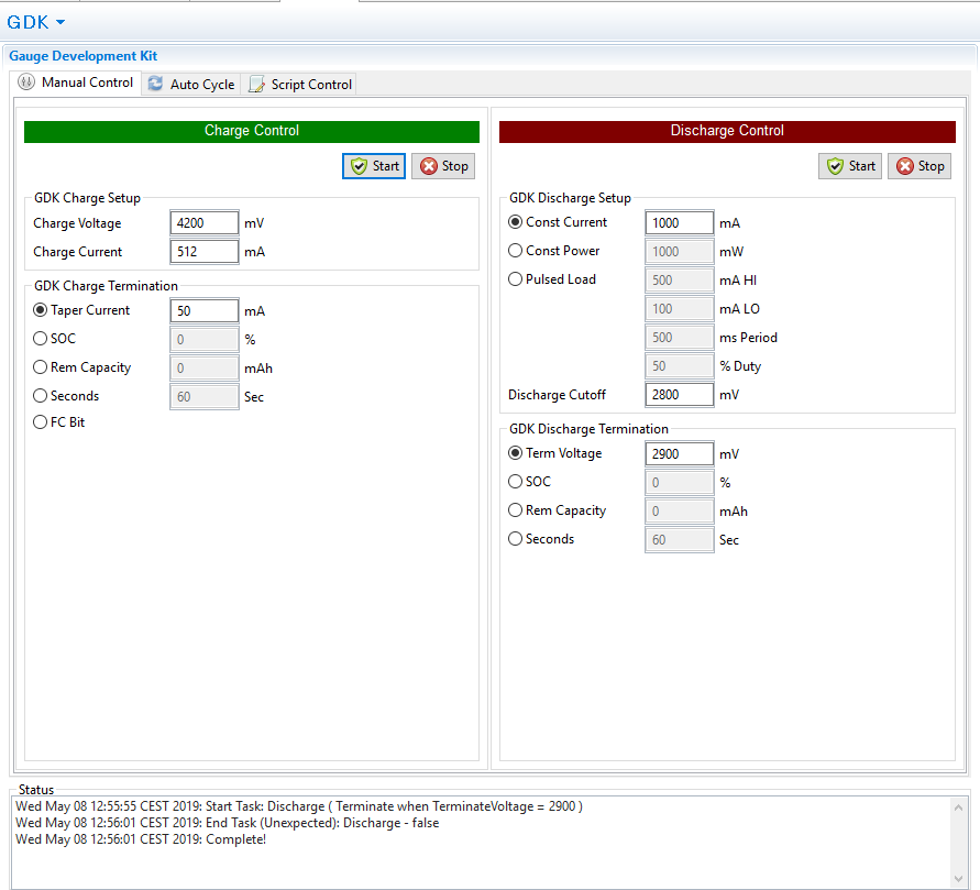

Following Onyx's advise, I press the black reset buttons for the two uC on the board and cycle power to the board. After ensuring both GDK and the gauge are already turned on, I try to discharge the battery by 100mA, 500mA, 1000mA, 1500mA and 1900mA constant current. All of them fail with the same error message as seen pictorially:
To provide more information, the voltage between TP1 (1P) and TP5 (1N) is 4129 mV. I measure the voltage between TP2 (Charger+/Load+) and TP6 (Charger-/Load-) as well:
- During both charge and discharge FET are on, the voltage is around 593 mV;
- During both FETs are off, the voltage is around 502 mV.
I don't know if this information is useful to solve my current problem. If any other information you want to know, just tell me.
