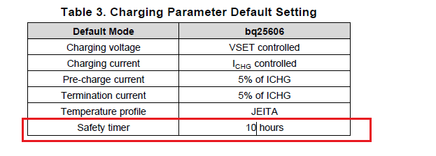

BQ25606: The BQ25606 specification indicates a built-in 10-hour timer.Does this mean that BQ25606 will turn off charging in 10 hours, so that I can never fill the battery with 2A?
Expert 2630 points
Part Number: BQ25606
My battery pack is 20000mAh.
Because the maximum charging current of BQ25606 is 3A,
If I charge my battery with 2A charging current,
It will take more than 10 hours to fill up.
  • Hi Clark,
    The charge safety timer can be reset by starting a new charging cycle (please see Section 8.3.6.6 in the datasheet for more details). For example, if the safety timer expires and causes charging to stop, then you can toggle /CE to start a new charging cycle and reset the safety timer.
