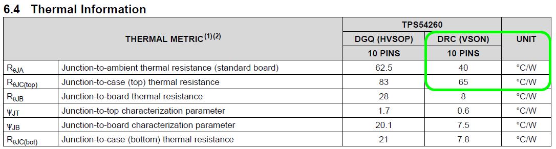

could you help to confirm Why RθJC(top) bigger than RθJA in datasheet of TPS54620?
